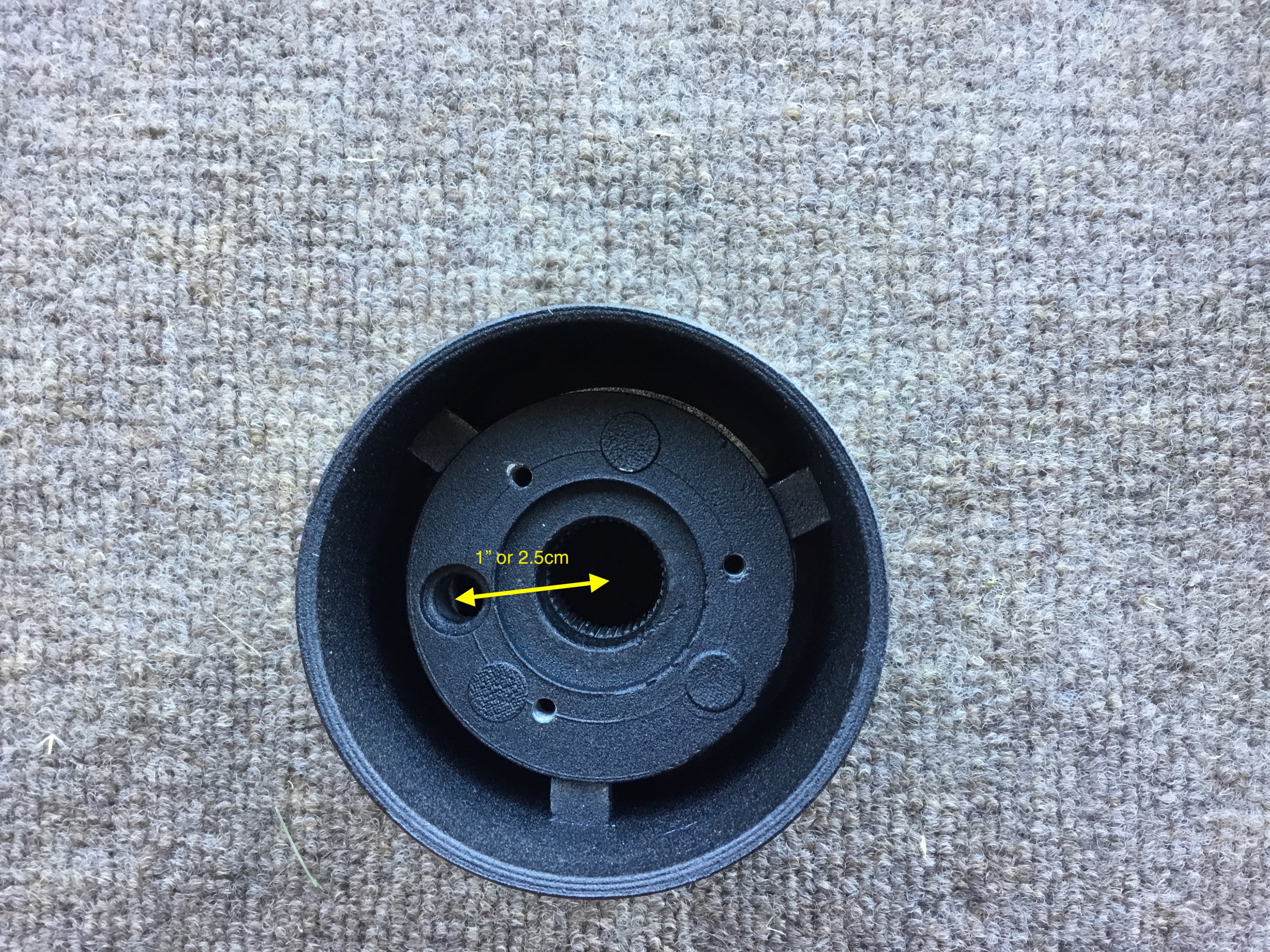

So here's the problem with the Luisi hub.
It all fits great and looks fine.
The problem is where the hole for the horn contact pin is located.
From the pic, you can see the center of horn pin contact hole is about 2.5mm from the center of the hub.

raynekat   So here's the problem with the Luisi hub. It a...   Nov 6 2019, 10:10 PM
raynekat   As compared to the factory wheel/hub which has it...   Nov 6 2019, 10:11 PM
raynekat   Well it is a problem when you consider the horn ri...   Nov 6 2019, 10:17 PM

raynekat   Gave up on the Luisi hub. It's not going to fi...   Nov 17 2019, 11:09 PM
raynekat   Momo 8000 hub attached to my Momo Prototipo.   Nov 17 2019, 11:10 PM
raynekat   This is the type of Momo horn button I have. Has t...   Nov 17 2019, 11:16 PM
