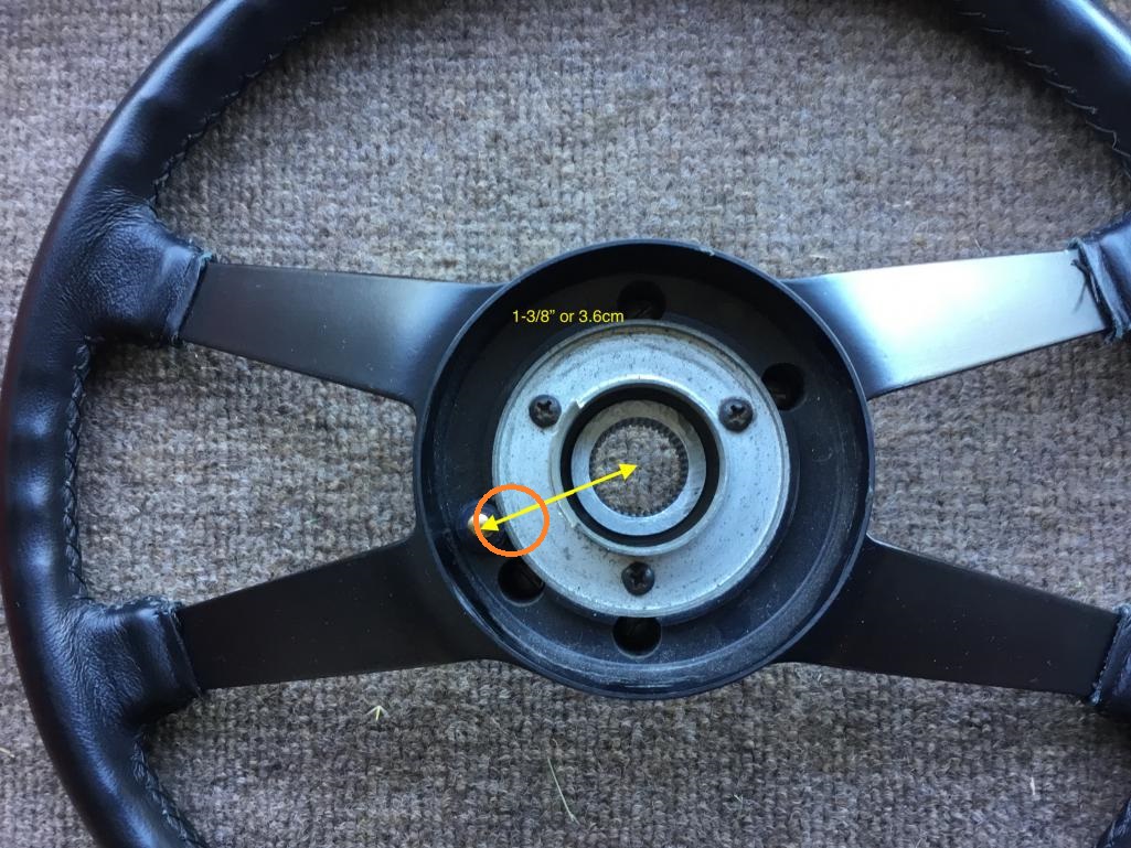

raynekat   So here's the problem with the Luisi hub. It a...   Nov 6 2019, 10:10 PM
raynekat   As compared to the factory wheel/hub which has it...   Nov 6 2019, 10:11 PM
raynekat   Well it is a problem when you consider the horn ri...   Nov 6 2019, 10:17 PM
infraredcalvin   How about moving the screws outward and filling t...   Nov 6 2019, 10:29 PM
