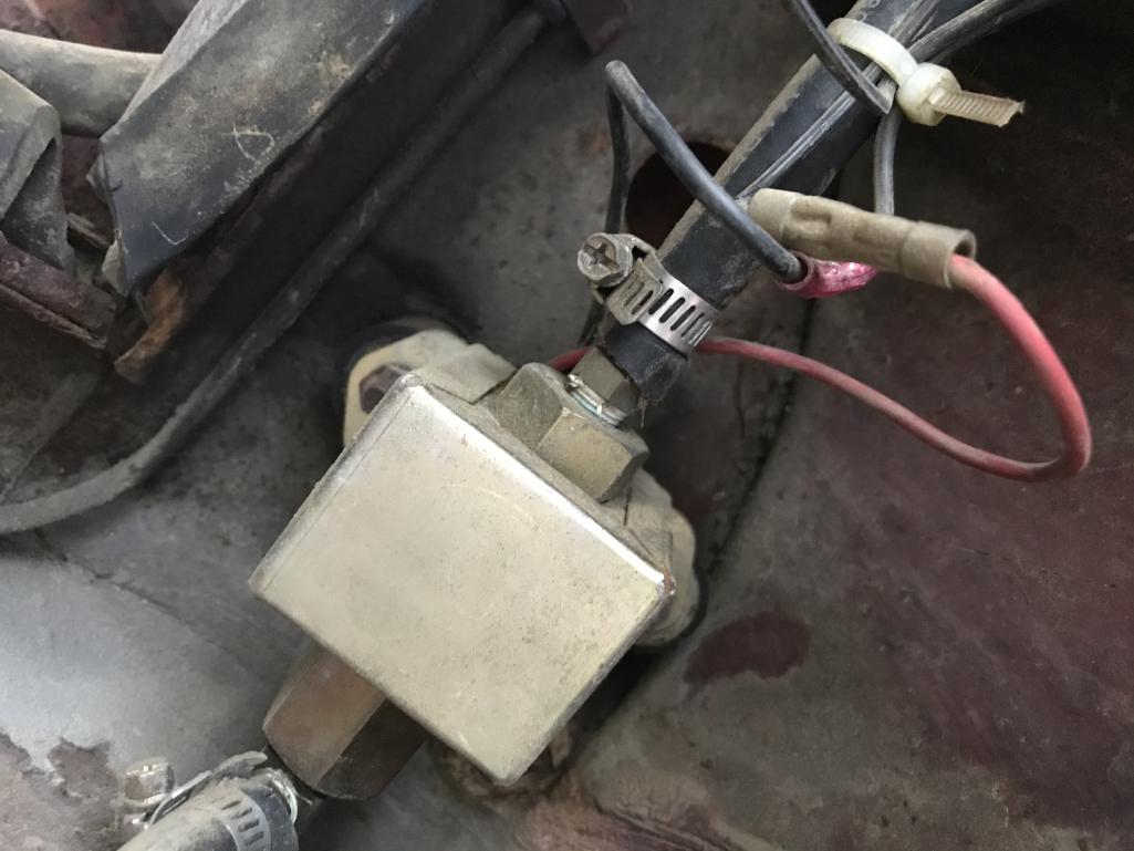

Just looked at ordering a low pressure fuel pump and the pictures look like the unit in my car (attached pic). I noticed the unit in my car looked newer than everything else. I'm thinking my mechanic friend had already put a low pressure fuel pump in there. But it's still not coming on.
Is there a way to unstick the fuel pump or does it need to be replaced?
Also, he had the fuel pump hot cable connected to the hot side of the ignition coil. That's not how I see it in the diagram but is that an alternative way of wiring it?
