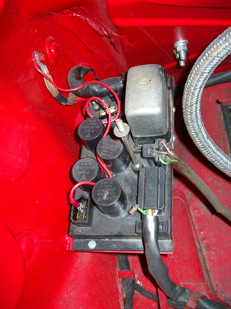

(IMG:style_emoticons/default/popcorn[1].gif) ISSUE: WHEN WE TURN THE KEY, THERE'S NO POWER TO THE COIL OR FUEL PUMP.
Since we replaced the fuel injection with carburetors, we no longer have the ECU in the car. (in fact, I no longer have the ECU or any of the fuel injection parts anymore, they are long gone at my other friends garage) Not sure if that was a mistake, I thought I didn't need it anymore since the FI was gone.
My VW friend is not familiar enough with 914 electrical to find the issue. Could I have a bad relay? I see that there is a port for the white wires from the ECU to connect to the relay panel. Is there a part I need there in place of the ECU wiring? Is this a common issue with a carb replacement? Other electrical things work, (headlights, and whatnot) and if I continue to turn the key, the starter starts to crank, but no power to the coil/fuel pump.

If you didn't ground pin III on the FI ECU connector like shown, the fuel pump relay will not pull in. This doesn't power the coil though.
