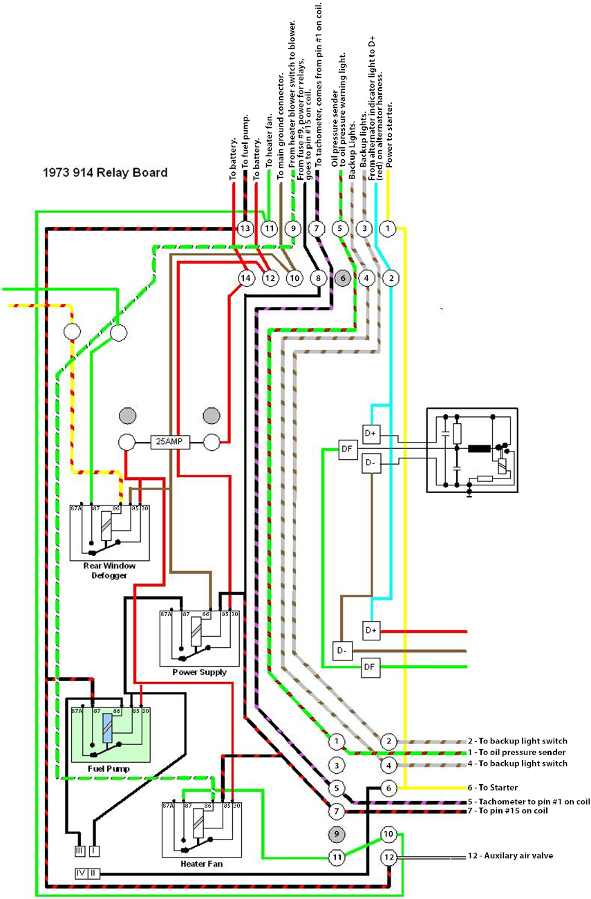

(IMG:style_emoticons/default/popcorn[1].gif) ISSUE: WHEN WE TURN THE KEY, THERE'S NO POWER TO THE COIL OR FUEL PUMP.
Since we replaced the fuel injection with carburetors, we no longer have the ECU in the car. (in fact, I no longer have the ECU or any of the fuel injection parts anymore, they are long gone at my other friends garage) Not sure if that was a mistake, I thought I didn't need it anymore since the FI was gone.
My VW friend is not familiar enough with 914 electrical to find the issue. Could I have a bad relay? I see that there is a port for the white wires from the ECU to connect to the relay panel. Is there a part I need there in place of the ECU wiring? Is this a common issue with a carb replacement? Other electrical things work, (headlights, and whatnot) and if I continue to turn the key, the starter starts to crank, but no power to the coil/fuel pump.

I just found this which I saved on my computer. Life saver that was given on a post when I was having trouble. Your fuel pump power is pin 13. Mine didn't work so I connected to pin 5 (I think) which worked with the key on and off. Works like a charm ever since.

pastormacman   Ok. Been busy with work but was able to work on th...   Dec 7 2019, 02:58 PM
pastormacman   So I decided to test the connection by pushing a p...   Dec 7 2019, 03:16 PM
rhodyguy   The 2 fuses on the relay board are filthy. Clean t...   Dec 7 2019, 04:13 PM
pastormacman   Are there any fuses or relays under the dash that ...   Dec 7 2019, 11:43 PM
porschetub   No none to worry about in that area,have you check...   Dec 8 2019, 01:33 PM
SirAndy   Did you check the fuel pump relay? Your relay boar...   Dec 8 2019, 02:28 PM
Spoke   You can test the relays involved with providing th...   Dec 8 2019, 10:23 PM
IronHillRestorations   Make sure the fuel hose isn't kinked, it's...   Dec 9 2019, 06:51 AM
pastormacman   Make sure the fuel hose isn't kinked, it...   Dec 14 2019, 12:30 PM
Tom   In your original post you said you had no power to...   Dec 9 2019, 08:46 PM
pastormacman   OK. I retested all the relays I have on the headli...   Dec 14 2019, 12:11 PM
Spoke   There is no power on either side of fuse #9 under...   Dec 14 2019, 12:58 PM
pastormacman   With the key OFF, there is no power to the fuses f...   Dec 14 2019, 01:35 PM
Spoke   With the key OFF, there is no power to the fuses ...   Dec 14 2019, 06:39 PM
pastormacman   OK, so here's my update for today. I can...   Dec 15 2019, 09:01 PM
Spoke   Those numbers go to somewhere else on the schemati...   Dec 16 2019, 08:43 AM
Spoke   Fuse 8 is powered by pin X on the ignition switch ...   Dec 16 2019, 08:56 AM
pastormacman   Fuse 8 is powered by pin X on the ignition switch...   Dec 16 2019, 06:50 PM
Tom   Pastormacman, It looks like you are using the ...   Dec 16 2019, 10:20 AM
pastormacman   Pastormacman, It looks like you are using the...   Dec 16 2019, 06:07 PM
Tom   More   Dec 16 2019, 10:21 AM
pastormacman   THANK YOU! I want to thank everyone who helpe...   Jan 2 2020, 03:53 PM
pastormacman   THE FACE I MADE WHEN MY CAR STARTED! After...   Mar 23 2020, 10:26 AM
