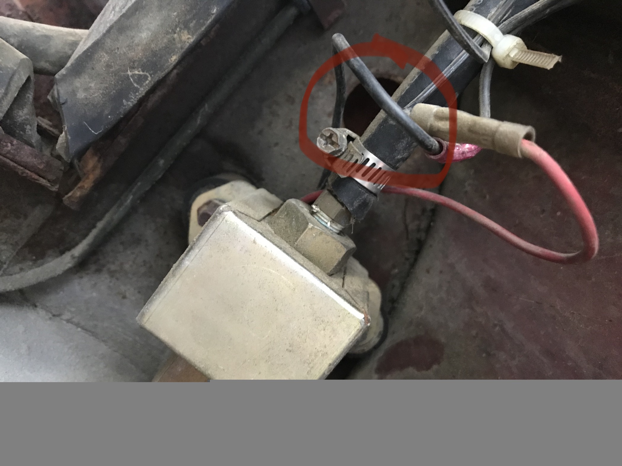

The plug end of the stock pump harness will have dif connectors. Make up a pig tail that works with the replacement pump. The relay board trick and start tracking circuits. Remove the coil from equation.
Is the facet mounted to the bottom of the engine shelve? Is that a J tube hole above it?

QUOTE(rhodyguy @ Nov 12 2019, 08:58 AM) *
Yes it's mounted to the bottom underside of the "hell hole"
I'm not sure what the J tube is. Is it the tube to drain the water from the engine lid? I think that might be it. My drainage tubes all disintegrated over time and are no longer there.
ndfrigi
post Nov 12 2019, 02:19 PM
Posts: 2,995
Joined: 21-August 11
From: Orange County
Member No.: 13,474
QUOTE(pastormacman @ Nov 12 2019, 12:13 PM) *
Is the circled one you are referring too?
that is the hole where the fuel pump wire coming from and should have a rubber gromet.
