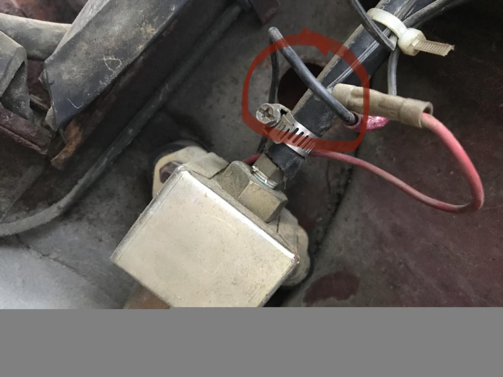

Is the facet mounted to the bottom of the engine shelve? Is that a J tube hole above it?

QUOTE(rhodyguy @ Nov 12 2019, 08:58 AM) *
Yes it's mounted to the bottom underside of the "hell hole"
I'm not sure what the J tube is. Is it the tube to drain the water from the engine lid? I think that might be it. My drainage tubes all disintegrated over time and are no longer there.
ndfrigi
post Nov 12 2019, 02:19 PM
Posts: 2,995
Joined: 21-August 11
From: Orange County
Member No.: 13,474
QUOTE(pastormacman @ Nov 12 2019, 12:13 PM) *
Is the circled one you are referring too?
that is the hole where the fuel pump wire coming from and should have a rubber gromet.

QUOTE(ndfrigi @ Nov 12 2019, 12:19 PM) *
I assumed that was the hole you were referring to. I'm not home right now so I can't take a look at it to confirm. By my memory I assumed it was the drainage hole, but it probably is the access hole for the Fuel pump wiring.
The connector and the rubber grommet are no longer on the wiring. The wiring is currently still up in the engine bay cut bare. I will eventually run them back down the access hole and crimp them to the red and black wires coming off the fuel pump, so that it's all running through the original wiring loom.
