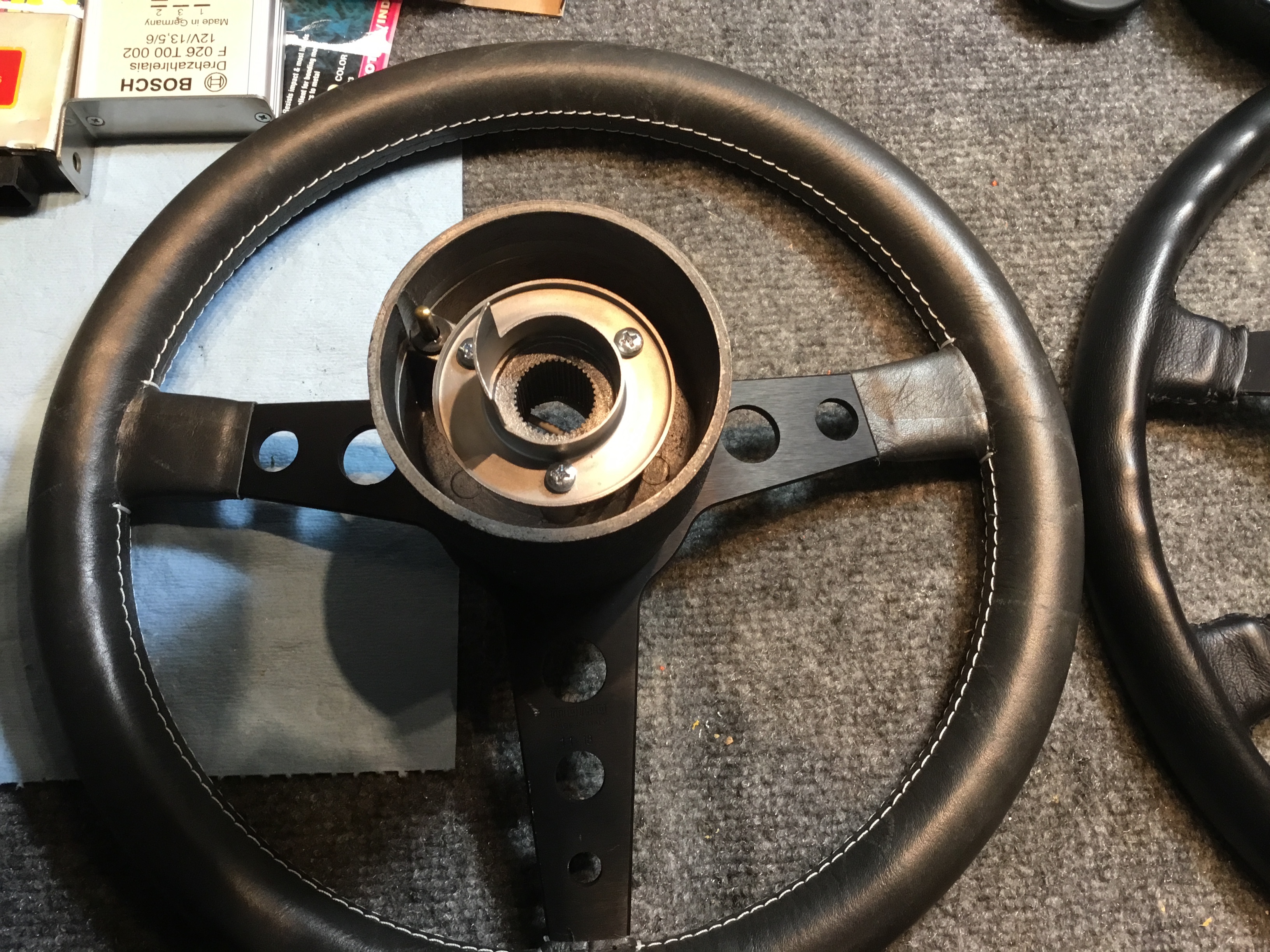

Momo 8000 hub attached to my Momo Prototipo.

raynekat   Gave up on the Luisi hub. It's not going to fi...   Nov 17 2019, 11:09 PM
raynekat   Momo 8000 hub attached to my Momo Prototipo.   Nov 17 2019, 11:10 PM
