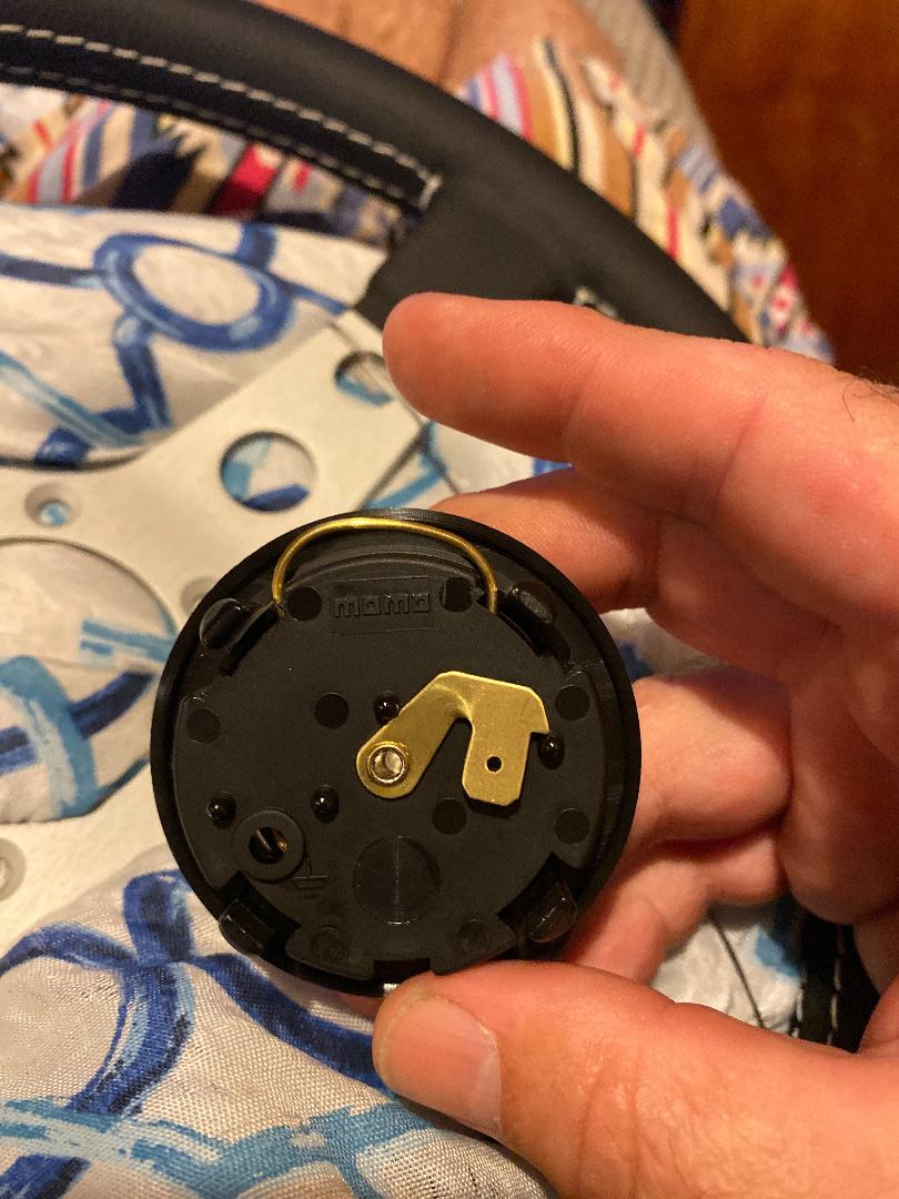

This is the type of Momo horn button I have.
Has the 2 electrical connections and the spring that holds the button
into the hub does not contact the inside of the hub.

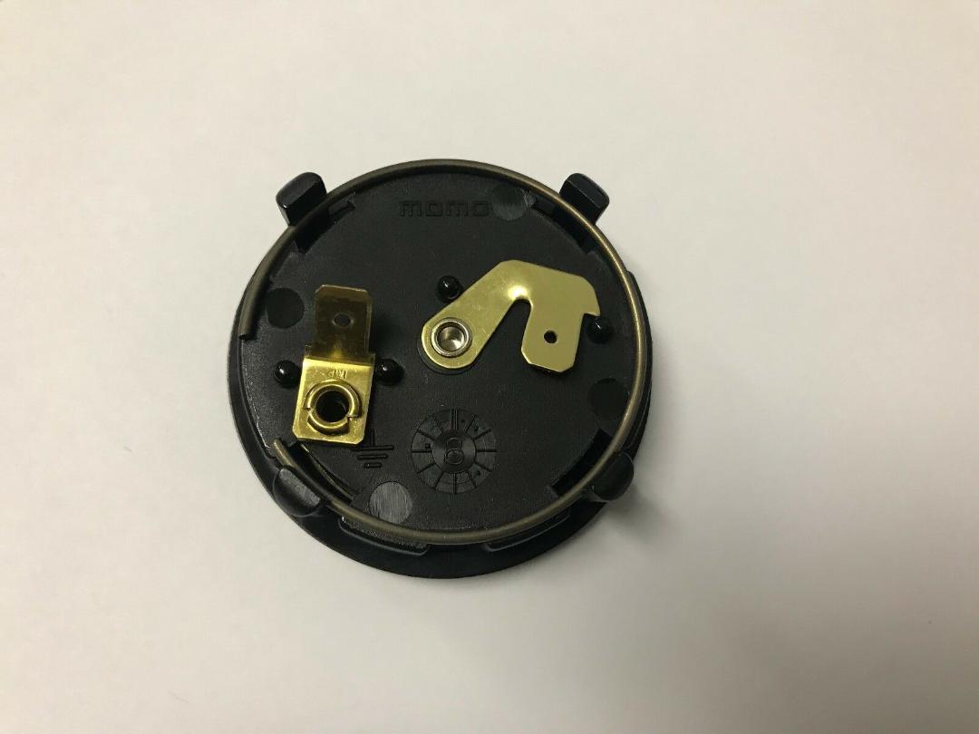

Apparently, this is the type of Momo horn button I need.
The spring that does contact the inside of the hub completes the circuit when you push the button.

raynekat   This is the type of Momo horn button I have. Has t...   Nov 17 2019, 11:16 PM
