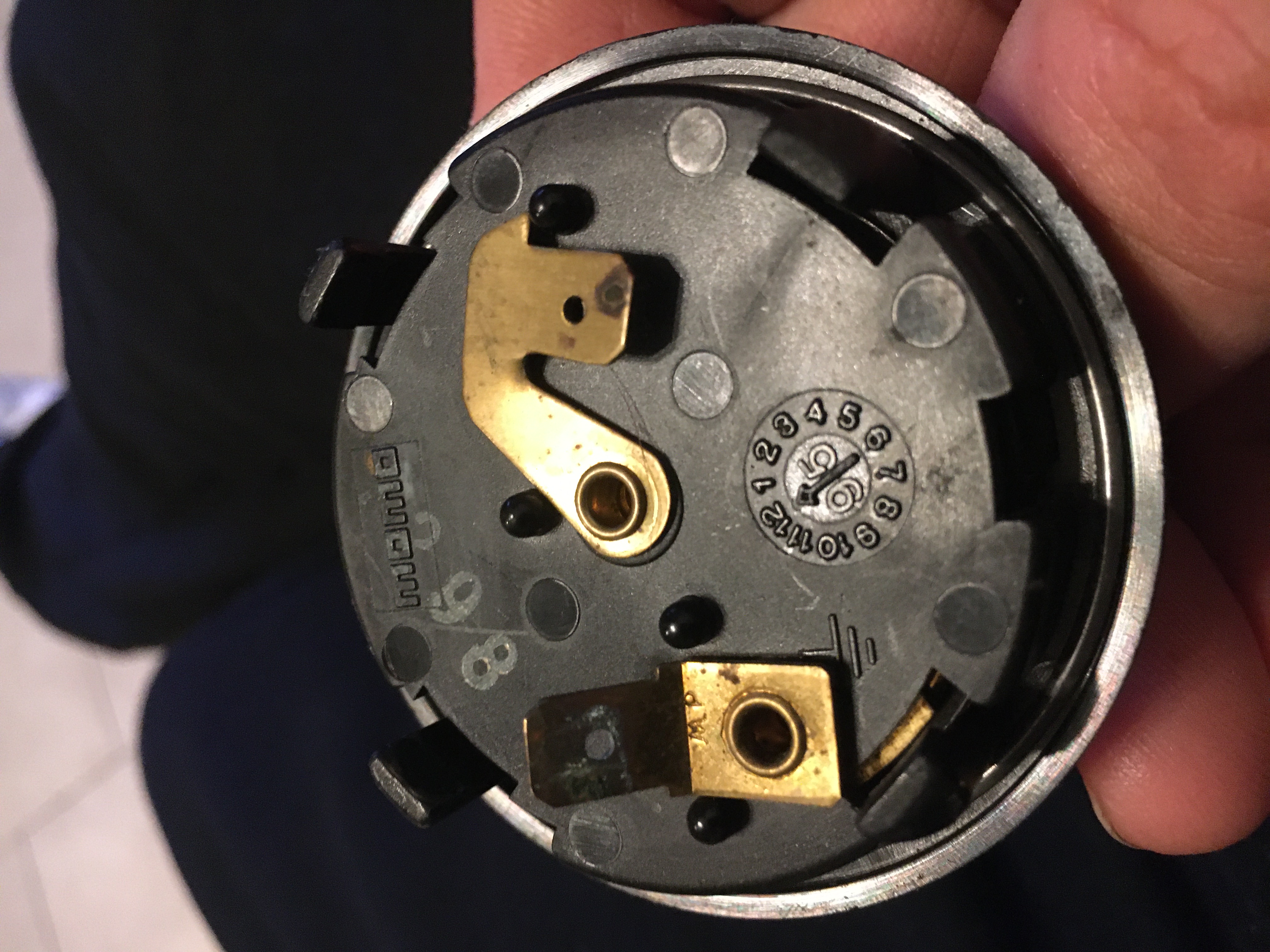

raynekat   This is the type of Momo horn button I have. Has t...   Nov 17 2019, 11:16 PM
