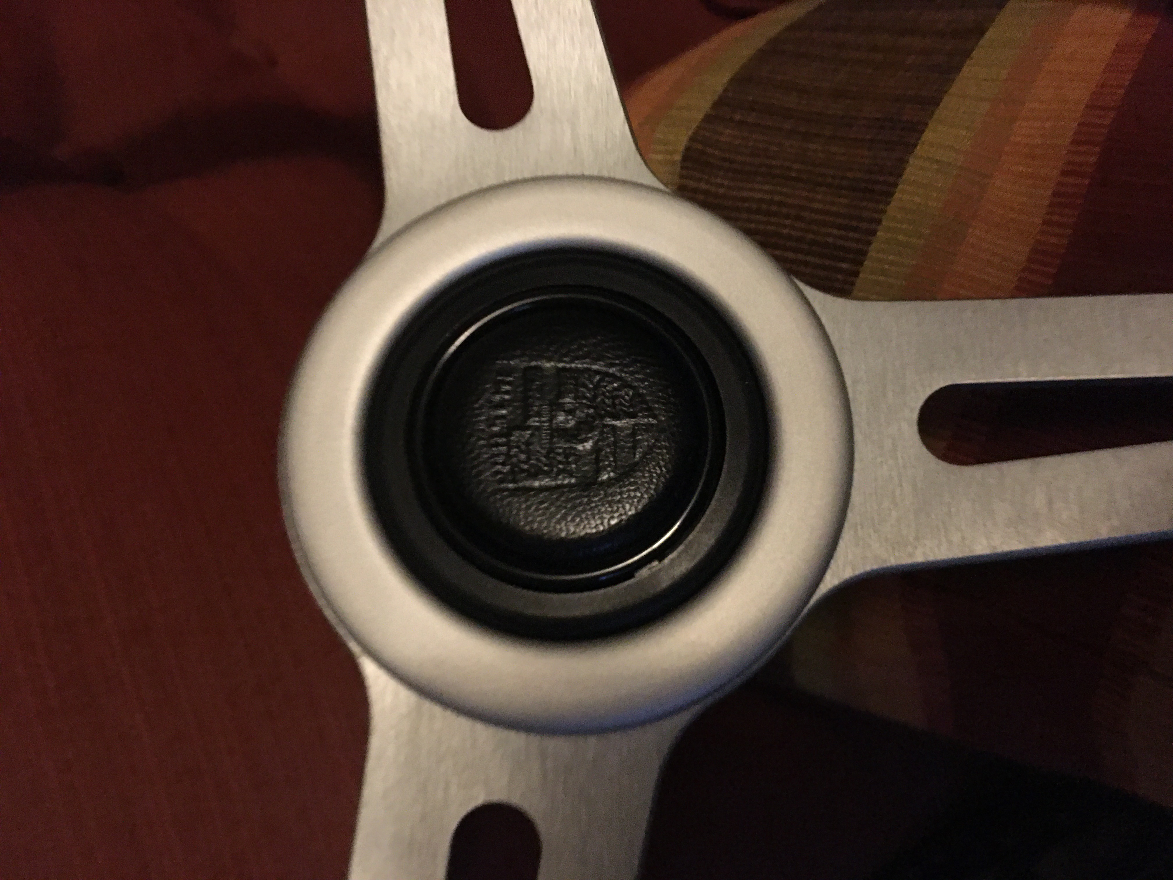

raynekat   So here's the problem with the Luisi hub. It a...   Nov 6 2019, 10:10 PM
raynekat   As compared to the factory wheel/hub which has it...   Nov 6 2019, 10:11 PM
raynekat   Well it is a problem when you consider the horn ri...   Nov 6 2019, 10:17 PM

raynekat   Gave up on the Luisi hub. It's not going to fi...   Nov 17 2019, 11:09 PM
raynekat   Momo 8000 hub attached to my Momo Prototipo.   Nov 17 2019, 11:10 PM
raynekat   This is the type of Momo horn button I have. Has t...   Nov 17 2019, 11:16 PM

Rob-O   Gave up on the Luisi hub. It's not going to f...   Nov 18 2019, 05:23 PM
raynekat   I did exactly as you did. I just snuck the wire ...   Nov 18 2019, 11:55 PM
Rob-O   Like this...   Nov 18 2019, 05:25 PM
