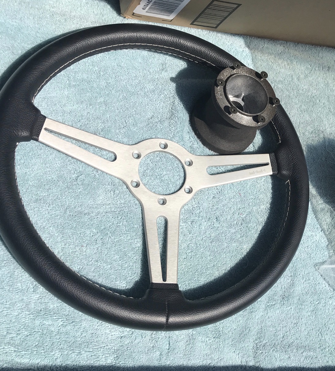

Having already received one Momo solid hub that wouldn't go on the steering shaft, on the recommendation of a gent who I buy tools and custom Porsche parts from I tried Amazon for what was purported to be a MOMO 8002 solid hub.
What showed up from "LTB Autosports" turned out NOT TO BE a solid hub as advertised.
Anyone can plainly see from the measurements this one wouldn't ever work regardless of configuation.
Before I raise the white flag I'm open to suggestions. Jimmy Tidwell made some of these at one time but as the market was covered he prefers to make things you cannot easily buy.
OTOH, Ive got a half dozen cool period wheels looking for a car. (IMG:style_emoticons/default/chowtime.gif)
Thanks
Tom
PS: Box is marked 89-97 Mazda Miata but also has a MOMO 8002 sticker "for Porsche" on it.

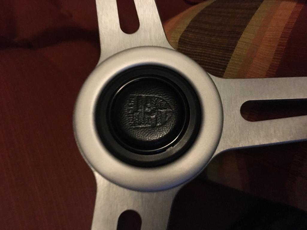

Rob-O   Gave up on the Luisi hub. It's not going to f...   Nov 18 2019, 05:23 PM
raynekat   I did exactly as you did. I just snuck the wire ...   Nov 18 2019, 11:55 PM
Rob-O   Like this...   Nov 18 2019, 05:25 PM
