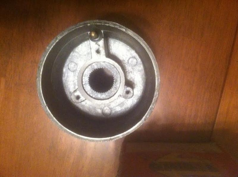

Having already received one Momo solid hub that wouldn't go on the steering shaft, on the recommendation of a gent who I buy tools and custom Porsche parts from I tried Amazon for what was purported to be a MOMO 8002 solid hub.
What showed up from "LTB Autosports" turned out NOT TO BE a solid hub as advertised.
Anyone can plainly see from the measurements this one wouldn't ever work regardless of configuation.
Before I raise the white flag I'm open to suggestions. Jimmy Tidwell made some of these at one time but as the market was covered he prefers to make things you cannot easily buy.
OTOH, Ive got a half dozen cool period wheels looking for a car. (IMG:style_emoticons/default/chowtime.gif)
Thanks
Tom
PS: Box is marked 89-97 Mazda Miata but also has a MOMO 8002 sticker "for Porsche" on it.

Bruce, your hub will not fit an early 914-4.
It will fit a 914-6.
They have totally different hubs.
The 914-6 takes a Mom0 0230 hub which what yours look like.
The hub for the early 914-4 needs to have a substantial recess like this:
Excuse my French....but your back of your hub protrudes. (IMG:style_emoticons/default/wink.gif)

I think you are correct on the fitment. I have a SWB column it should fit. Will cross check the Momo 230 fitment.
