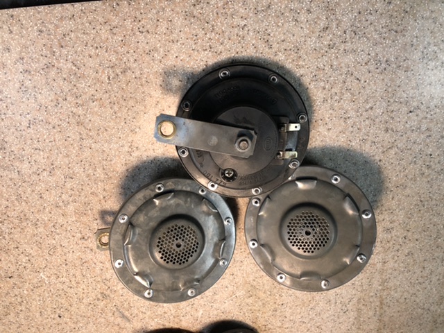

I have had much success with rebuilding the early original style horns. I adjust them to the highest note. With the dual horns, I find them to be plenty loud.
I’ll try and send some pictures.
Bruce Edge
