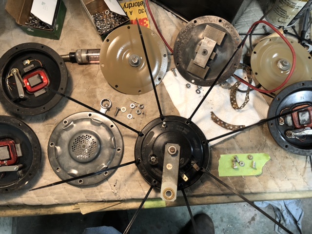

Bruce Edge   I have had much success with rebuilding the early ...   Nov 23 2019, 08:07 AM
Bruce Edge   Hey again, Tried to send more pictures, but had pr...   Nov 23 2019, 08:11 AM
dakotaewing   Hey again, Tried to send more pictures, but had p...   Nov 23 2019, 03:02 PM
Bruce Edge   Hey again, Tried to send more pictures, but had ...   Nov 23 2019, 09:15 PM
