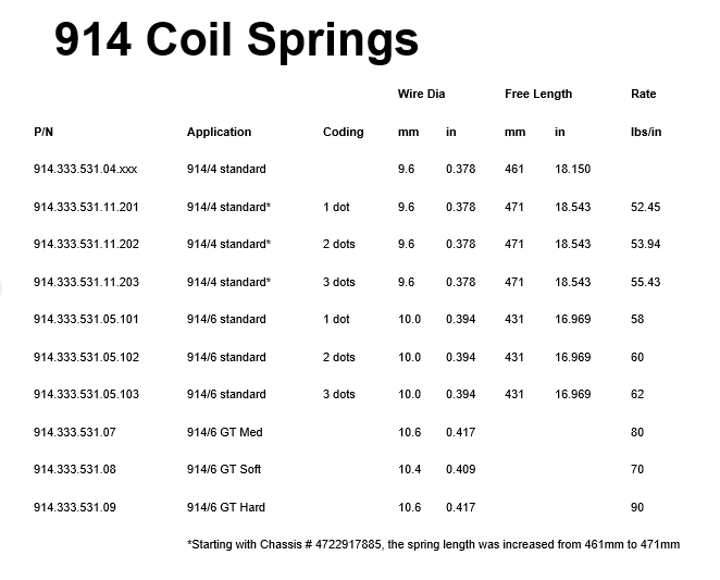

I would like to know the stock rear spring rate for a 74 914 2.0 w/ perforomance package.. the black springs with the green paint....

perrin1097   Stock Rear Spring Rate?   May 15 2009, 05:33 PM
RobW   I think stock is 100lbs. After 34 years?   May 15 2009, 05:39 PM
Larry Hubby   I believe all the 4 cylinder cars had 88 lb/in rea...   May 15 2009, 05:39 PM
bandjoey   what do the colored strips mean on the springs? G...   May 15 2009, 07:32 PM
Dave_Darling   According to an old Up-Fixin Der Porsche article, ...   May 16 2009, 09:33 AM

orcadigital   Weren't there 3 spring rates from the factory,...   May 22 2009, 10:50 PM
ArtechnikA   /4's were "a little more than 50" /6...   May 23 2009, 01:54 PM

mepstein   Stock front torsion bars, 100lb rear springs, Bils...   Nov 25 2019, 11:57 AM
Mikey914   I'd agree the 100 for the stock 4 is perfect. ...   Nov 25 2019, 12:05 PM
mepstein   I'd agree the 100 for the stock 4 is perfect....   Nov 25 2019, 12:10 PM
jmitro   EDIT nevermind; looks like someone bumped it as a ...   Nov 25 2019, 05:25 PM
porschetub   Mine are blue with no paint marks or writing PO sa...   Nov 25 2019, 07:40 PM
Mikey914   If they are factory I can guarantee they are not 1...   Nov 26 2019, 12:08 AM
Matty900   I started to put some spring information together ...   Nov 26 2019, 03:34 AM
dr914@autoatlanta.com   here is a bit of a study our spring guy did   Nov 26 2019, 10:28 AM
