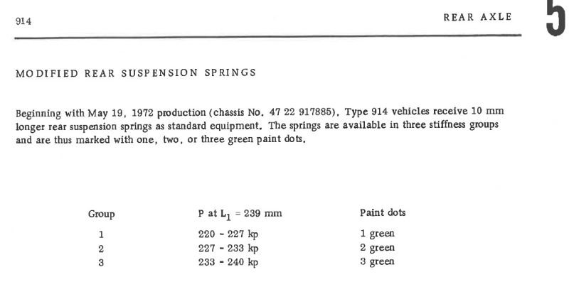

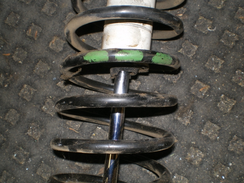

bandjoey   what do the colored strips mean on the springs? G...   May 15 2009, 07:32 PM
Dave_Darling   According to an old Up-Fixin Der Porsche article, ...   May 16 2009, 09:33 AM
74914LE   This brings up a great question. How do you tell ...   May 21 2009, 10:20 PM
SirAndy   This brings up a great question. How do you tell...   May 21 2009, 10:39 PM
Dave_Darling   This brings up a great question. How do you tell...   May 23 2009, 10:53 AM

ArtechnikA   /4's were "a little more than 50" /6...   May 23 2009, 01:54 PM
