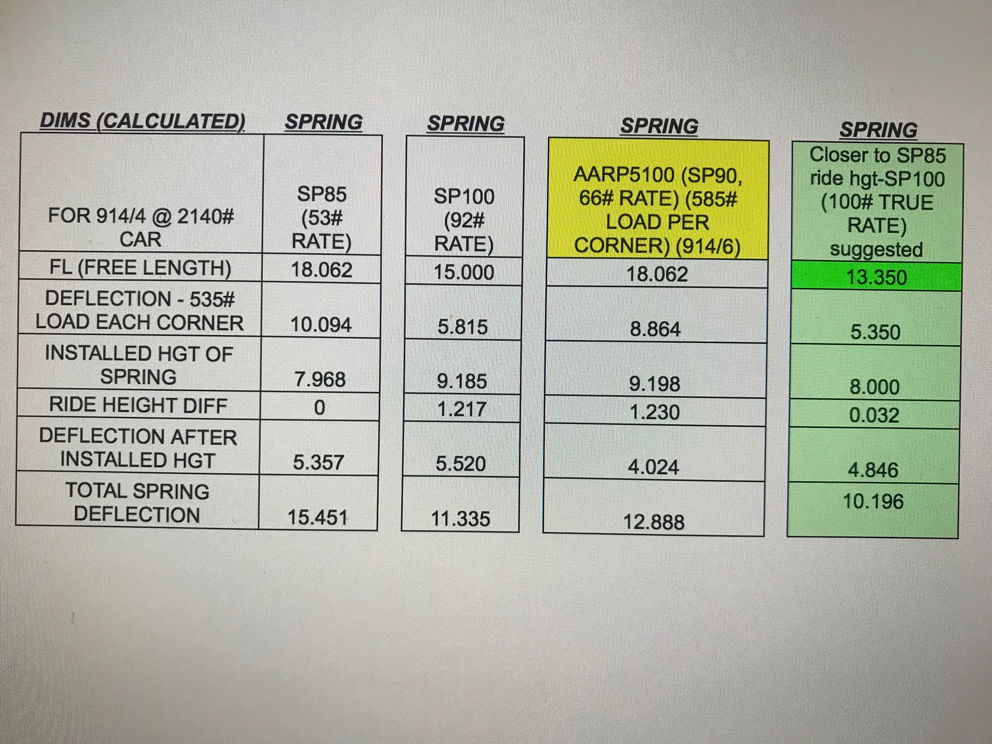

here is a bit of a study our spring guy did Attached Image

RobW   I think stock is 100lbs. After 34 years?   May 15 2009, 05:39 PM
Larry Hubby   I believe all the 4 cylinder cars had 88 lb/in rea...   May 15 2009, 05:39 PM

Dave_Darling   According to an old Up-Fixin Der Porsche article, ...   May 16 2009, 09:33 AM

ArtechnikA   /4's were "a little more than 50" /6...   May 23 2009, 01:54 PM

mepstein   Stock front torsion bars, 100lb rear springs, Bils...   Nov 25 2019, 11:57 AM
Mikey914   I'd agree the 100 for the stock 4 is perfect. ...   Nov 25 2019, 12:05 PM

porschetub   Mine are blue with no paint marks or writing PO sa...   Nov 25 2019, 07:40 PM
Mikey914   If they are factory I can guarantee they are not 1...   Nov 26 2019, 12:08 AM
Matty900   I started to put some spring information together ...   Nov 26 2019, 03:34 AM

johnhora   For reference... a pair of early springs off the s...   Nov 27 2019, 11:47 AM
