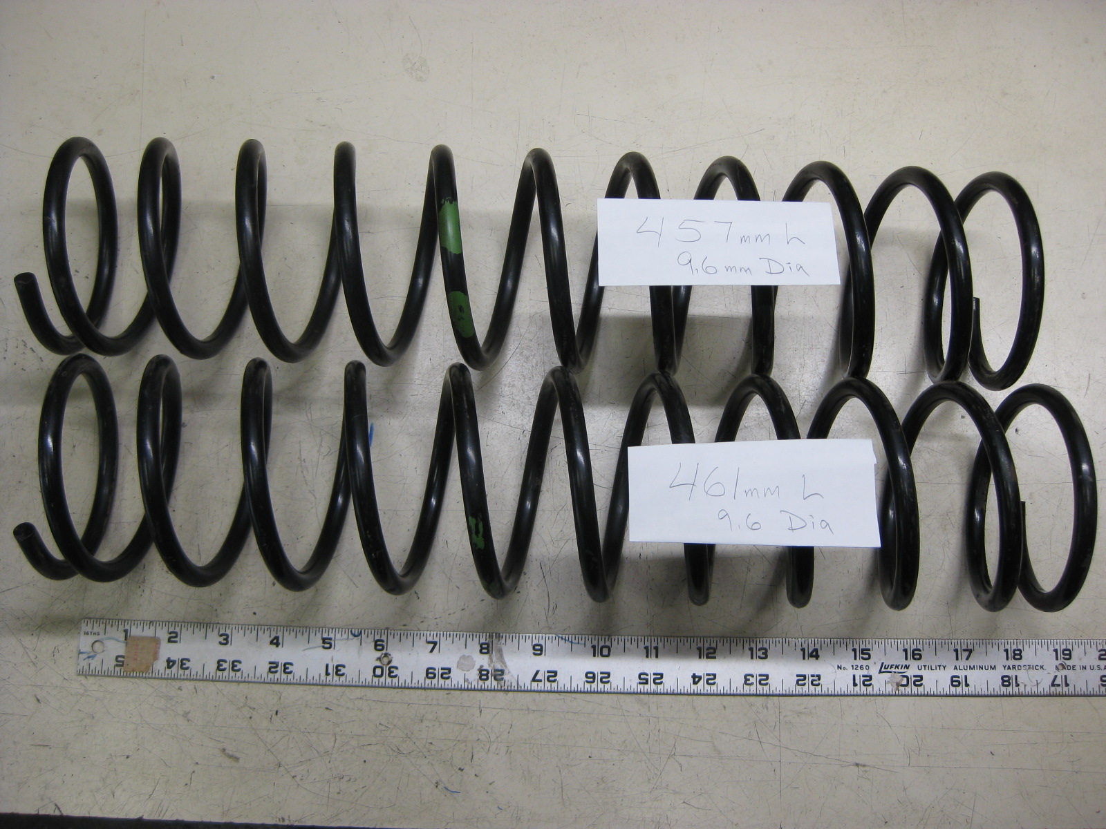

For reference...
a pair of early springs off the same car...you can see the 2 green paint spots.
the top one is 4mm shorter....maybe from the driver side
