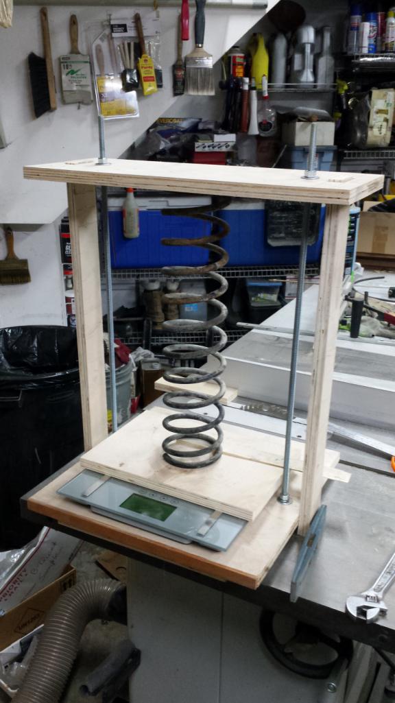

Don't know how much difference it makes, but I read it is best to compress 1" to preload the sprig first, take a reading, then compress another inch and subtract the two measurements. Here's my ghetto spring tester i action. Would have been better to use a cheaper scale. These fancy electronic scales are only good for telling you how fat you are.
Yes, a good ol' mechanical scale is what I used. Stock springs aren't progressive so measuring just the first inch should yield the same rate per inch as the following 4". I recall taking measurements as far as the scale and jig would safely read just for giggles.
