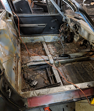

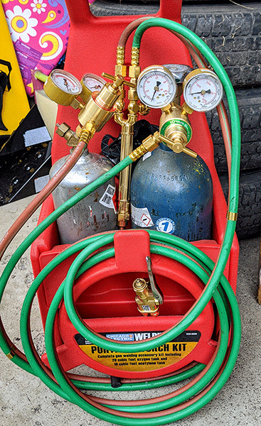

Okay, pictures that I did take during the teardown and inventory of the chassis are coming with the next post. I wanted to mention the best addition to my tool arsenal for the project so far.
The lugs, suspension, steering rack, trailing arms, etc. gave me fits - the car had obviously been sitting (and rusting) for years. I tried, propane, PB blaster, mechanical leverage (up to 6-7' with cheater), and an air impact gun. No dice.
Once I got this setup, along with the #6 heating tip, all I ever needed to do was heat the stuck nut/bolt until it just started to glow red and every single time the fastener came loose without any issue whatsoever.
I wish I had this sucker 25 years ago when I did my last 914 project. All hail my trusty little HF oxy/acetylene torch!
eatpez
post Dec 3 2019, 08:12 PM
Posts: 18
Joined: 4-October 18
From: Michigan
Member No.: 22,543

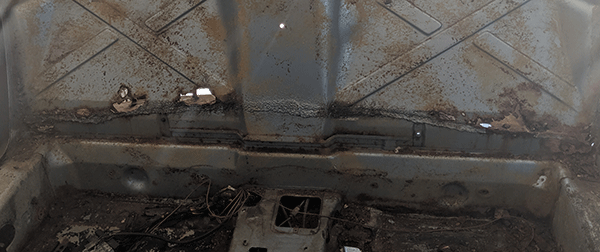

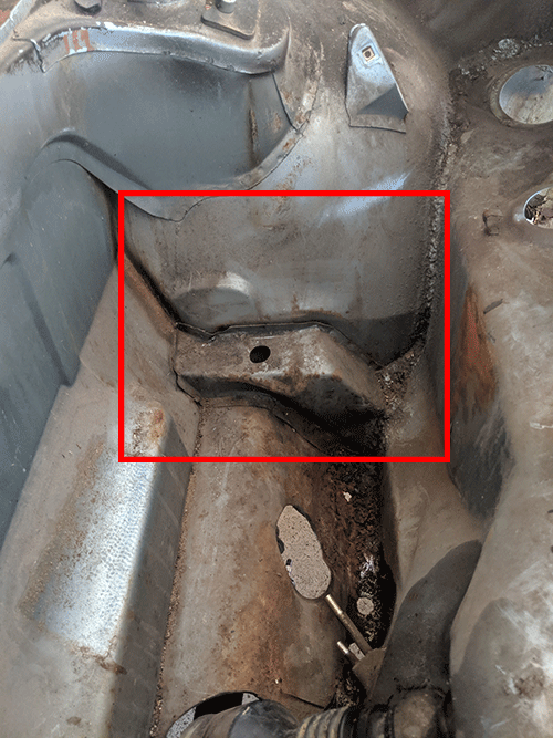

Here are the pictures I took during the teardown. The neighbor's cat was interested in what was going on - you can see the car has been through many colors and as I learned in going over it - also had many battle scars.

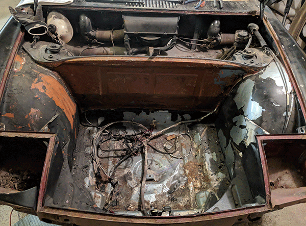

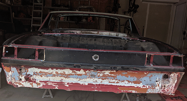

The rear panel was really weak in a few places, as well as the rear trunk pan, and I decided that I was going to replace the entire panel instead of doing the fabrication work to clean it up. More on that later.

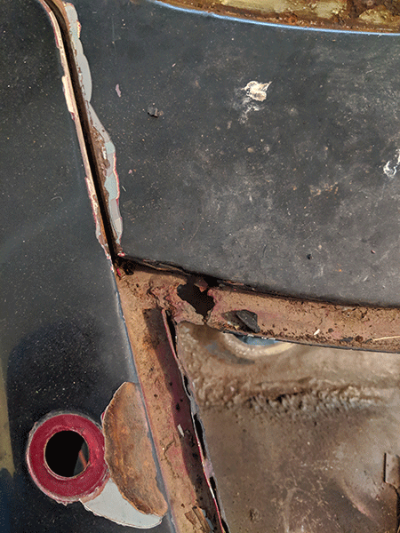

The area blocked in red, more pictures to come, was evidence of an old accident where front half of the inner front fender was replaced but the damage also affected the area where the sway bar comes through as well as the bracket just under it. I've since found a donor piece to patch it in later. Thanks to Garold down in NW Indiana for hooking me up with some hunks off of one of his chassis (more pictures to come on that too).
The longs and suspension points were solid, but it I plan on replacing: rear panel, rear trunk pan, floor plan, front trunk floor plan in addition to the fab work to fix up the firewall and the engine bay (hell hole, battery tray).
Typical lower windshield rust.
