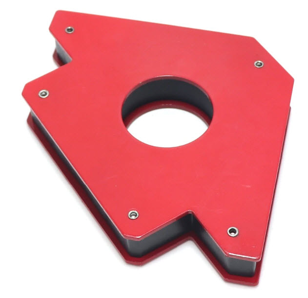

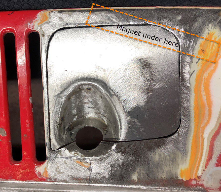

After fabricating a small repair panel the mostly enjoyable part of welding it in place remained. I made some spot welds to see the fit and called it a night. The next evening I continued to seam weld the rest. It went fine except from about one quarter of the weld in one of the corners where the weld turned out really terrible with a lot of splatter and holes. I redid this corner several times, grinding away the bad job each time, but still, I was suddenly a useless welder. After thoroughly ensuring there were no bondo or lead soldering left in the area, I started blaming the equipment. I dismounted and cleaned the nozzle and tightened the feeder mechanism. Not finding anything wrong I started suspecting someone had borrowed my equipent and messing with my settings. After spending some time figuring out nothing was changed I then turned what was now great anger and fury towards the plate part again. I decided making the gap a bit larger would solve all my problems. Even this turned out more challenging than expected. Why is this thin plate so much work to cut through?? Oh, the welder magnet is under there apparently.. (IMG:style_emoticons/default/welder.gif)
