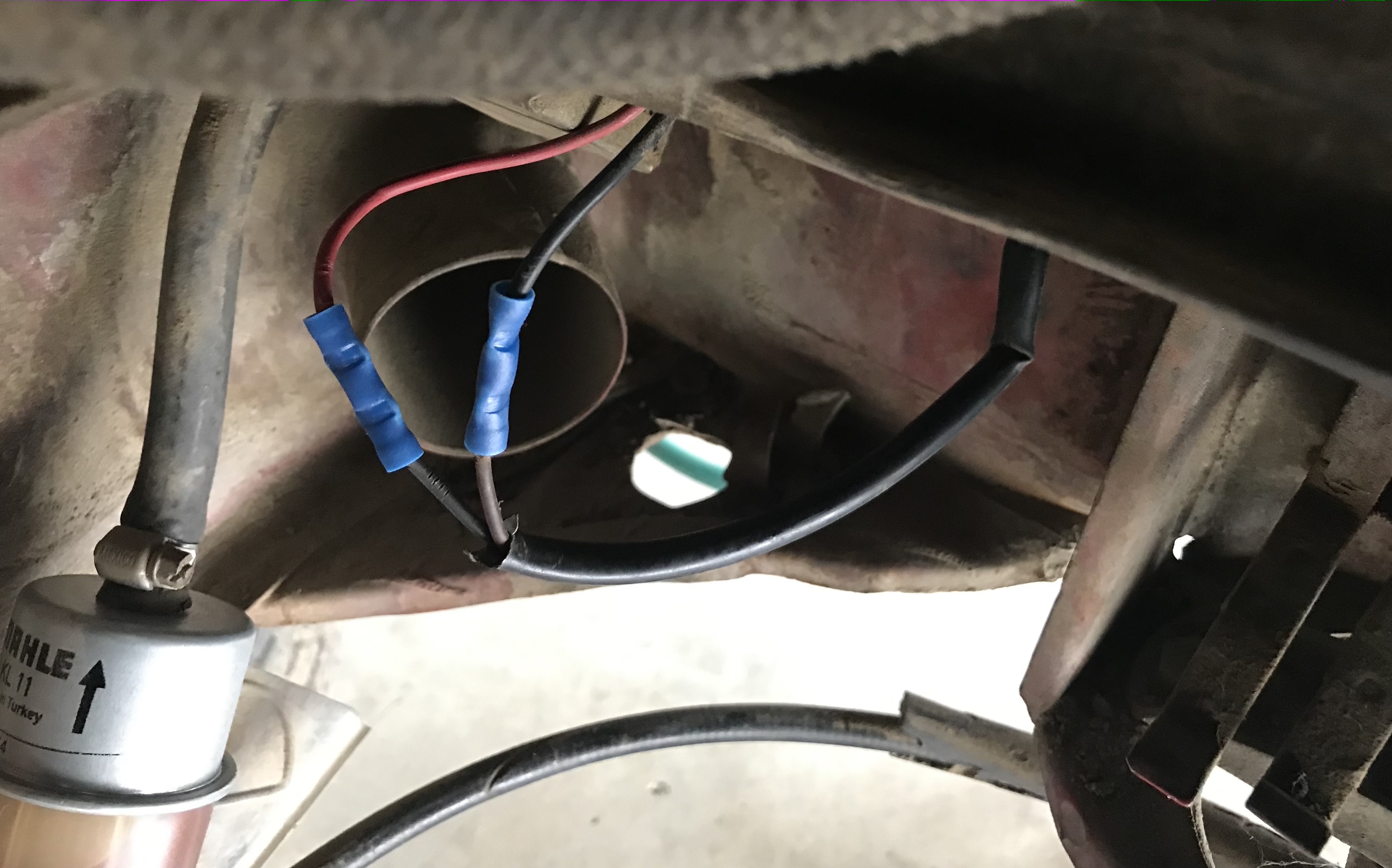

Ok. Been busy with work but was able to work on the car recently. I got a regular alligator clip test cable and tested the red wire from the fuel pump to the hot on the battery and low and behold, I heard the fuel pump kick on.
So I went ahead and rewired the pump back into the original wiring harness (Black/red to red and brown to black).

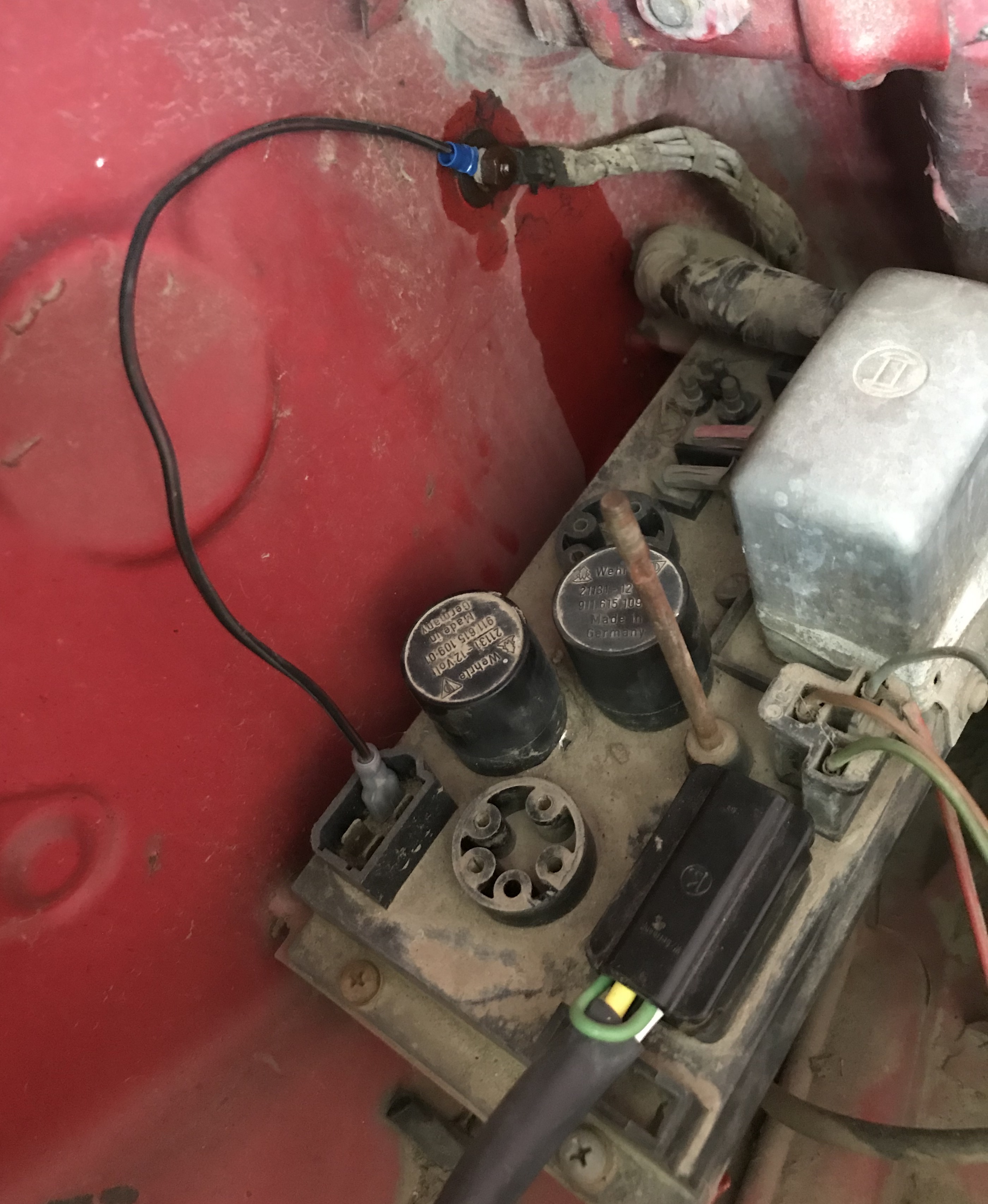

I also created the jumper wire from pin one to ground as Andy's tutorial says. I turned the key and...
NOTHING. Fuel pump does not turn on. Did I miss something?
