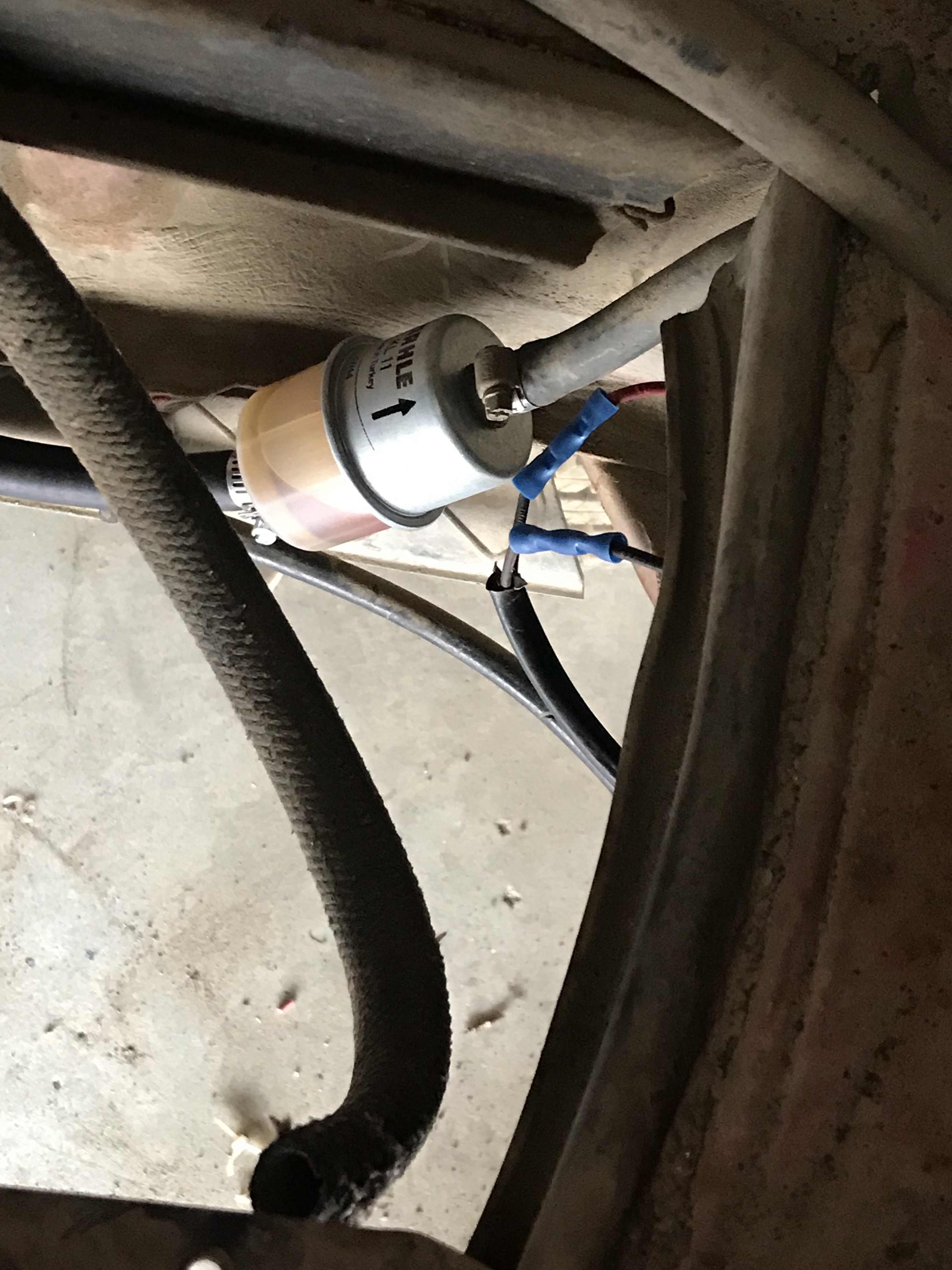

So I decided to test the connection by pushing a probe into the black/red side of the crimp connector going to the red fuel pump wire. And I touched the hot on the battery and current ran through the connection and the fuel pump came on. So I know the connection is good.
However, something else is troubling me. I let the fuel pump run for 20-30 seconds but no fuel showed up in the upper fuel filter between the carbs. I can see fuel in the lower filter but it's not full. Should it be full? I've got about 2-3 gallons of fuel in the tank and I can see fuel in the tank when I shine a light in it.
Any idea why fuel isn't making it to the upper fuel filter?
