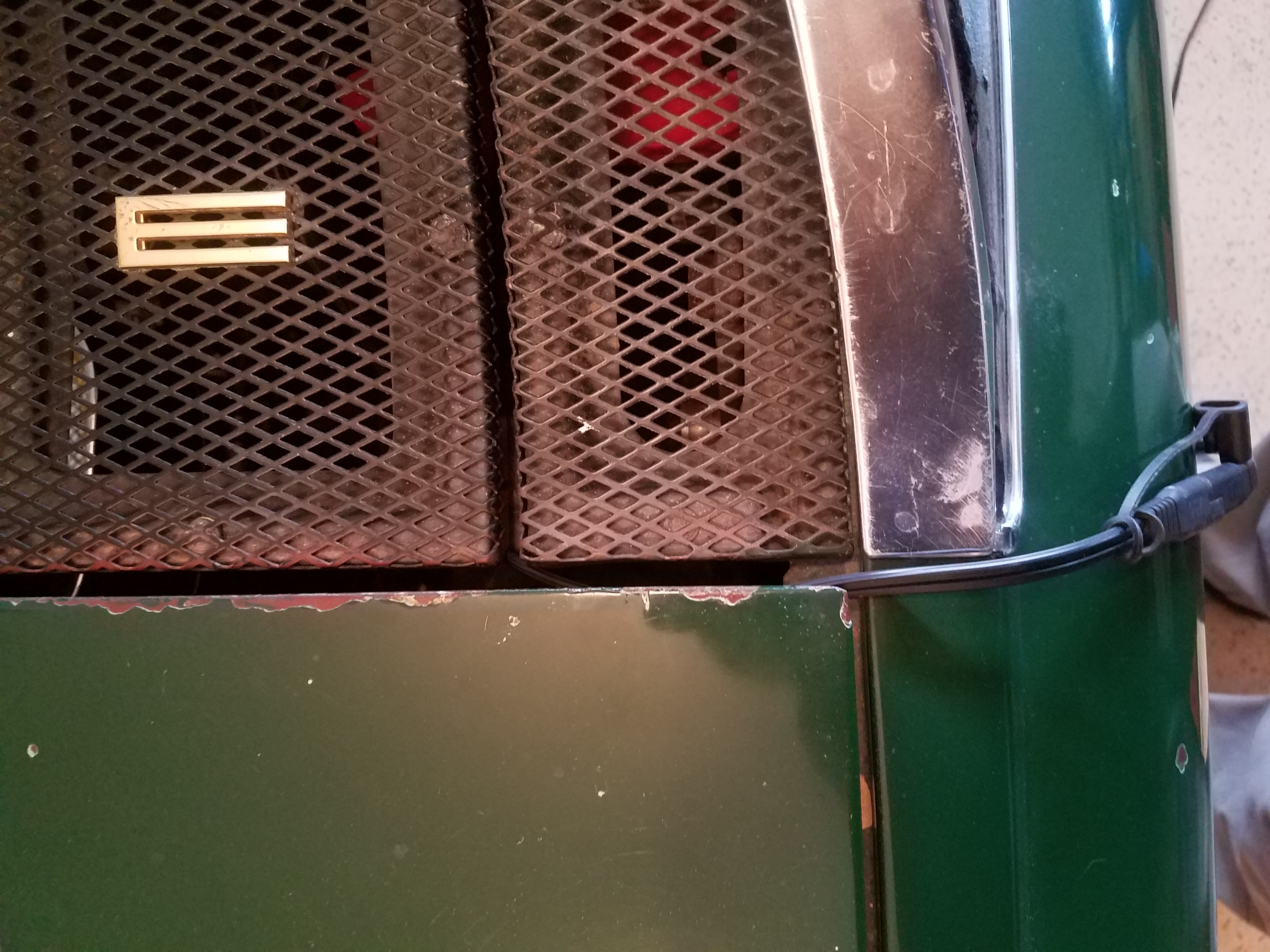

I fixed alignment on passenger side of engine lid. It had been making contact with the front edge of the rear trunk lid.
The engine cover and especially the rear trunk lid are/were way out of alignment.
The rear trunk hinge mounts are seriously messed up. The passenger side trunk mount bracket is most of the way broken off. the drivers side has been replaced with a big chunk of aluminum plate.
The trunk lid hinges on both sides needs to be fixed correctly before I try to fix the engine lid alignment on the drivers side.

AZBanks   drivers side alignment. Yes it is making contact.   Dec 11 2019, 11:48 PM
