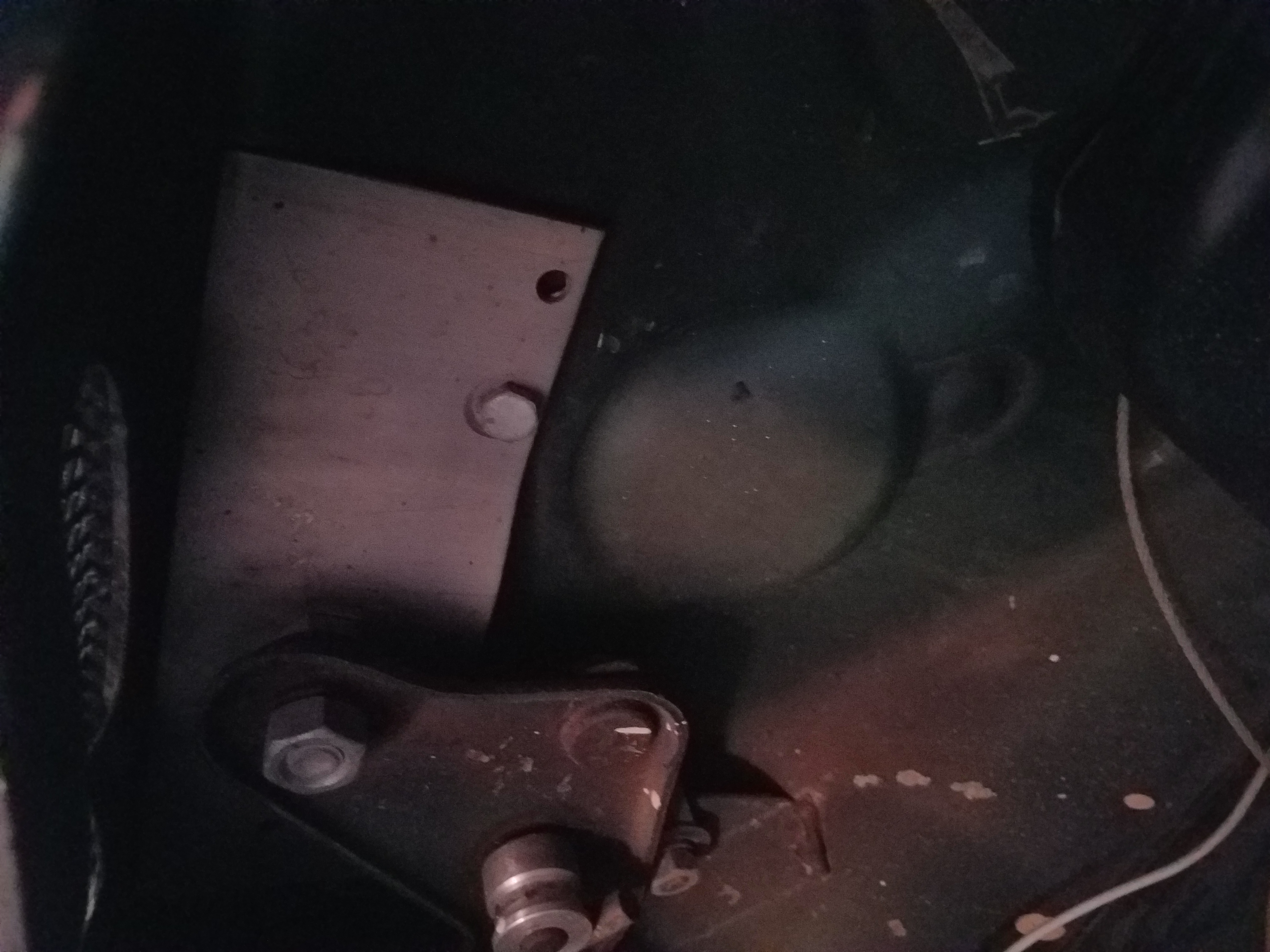

AZBanks   I fixed alignment on passenger side of engine lid....   Dec 11 2019, 11:45 PM
AZBanks   drivers side alignment. Yes it is making contact.   Dec 11 2019, 11:48 PM
AZBanks   Drivers side trunk mount hinge.   Dec 11 2019, 11:49 PM
