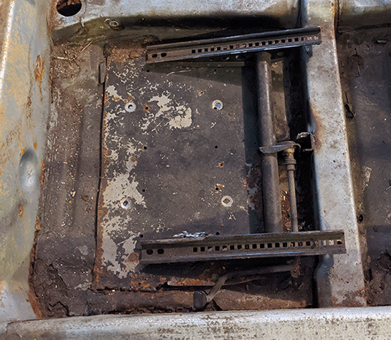

1. At some point someone thought it would be great to just weld in a piece of plate with a few stitches and the seat rails to that. The floor definitely needs to go and I'm considering boxing it in for re-enforcement. Those decisions will be deferred until after I have the chassis restoration done and decide on the powertrain.

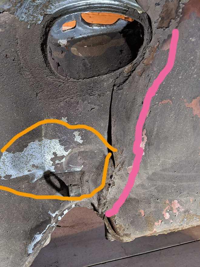

2. A view of the inner passenger side front well - to the left of the pink line in the seam where the repair was made from accident damage, but the area circled in orange is also still out of shape and since this is where the sway bars come through and the a-arm attaches underneath, I've got a donor section that I'm going to swap in here.

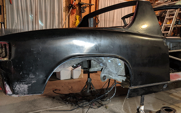

A wide shot of the rear fender:

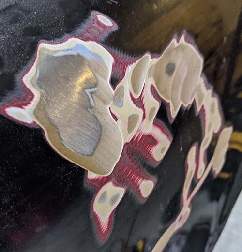

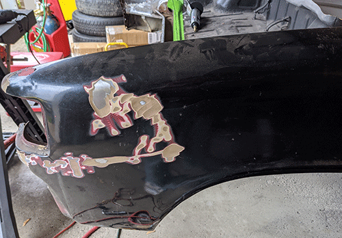

After removing the rear panel, I noticed bomdo and accident damange, removing a little paint to see how bad it was:
And here is a close up, way to much bondo and not enough work with a body hammer by the PO. As a result, if I can find someone who has the rear half of the passenger rear fender around, I'll take it and replace the entire section - especially because the rear section around the taillight is out of shape as well.
That's a lot of bondo.

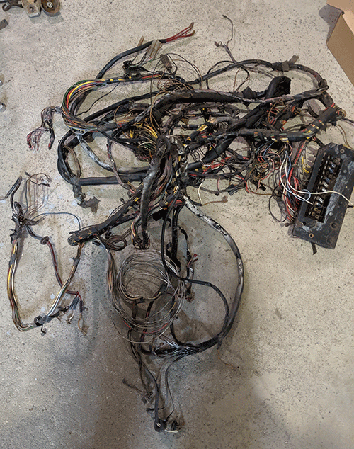

Also pulling the wiring completely out was a tedious as usual, especially getting the rear section up through the firewall and center tunnel. Why that little turn is in there at the rear of the center tunnel is beyond me.
