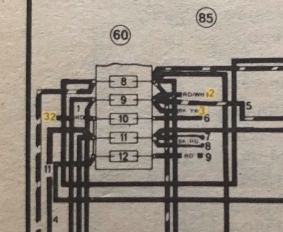

OK, so here's my update for today.
I can't get brake lights or signal lights to come on with the key on or off.
However, I did notice that I get hot on both sides of fuse #8 when the key is ON but nothing when the key is OFF. So the ignition switch is doing SOMETHING. But I never get hot to fuse #9 no matter what, key on or off.
Also, side question. I'm trying to understand the wiring diagrams better but I have a question. Most wires show where they are coming and going. But some wires seem to just end at a number and I don't know what that number means. I included a pic of a blow up of the wiring diagram and highlighted a few of the numbers that I'm talking about. What do those numbers mean and where are those wires going?Attached Image

Spoke   Those numbers go to somewhere else on the schemati...   Dec 16 2019, 08:43 AM
Spoke   Fuse 8 is powered by pin X on the ignition switch ...   Dec 16 2019, 08:56 AM
pastormacman   Fuse 8 is powered by pin X on the ignition switch...   Dec 16 2019, 06:50 PM
