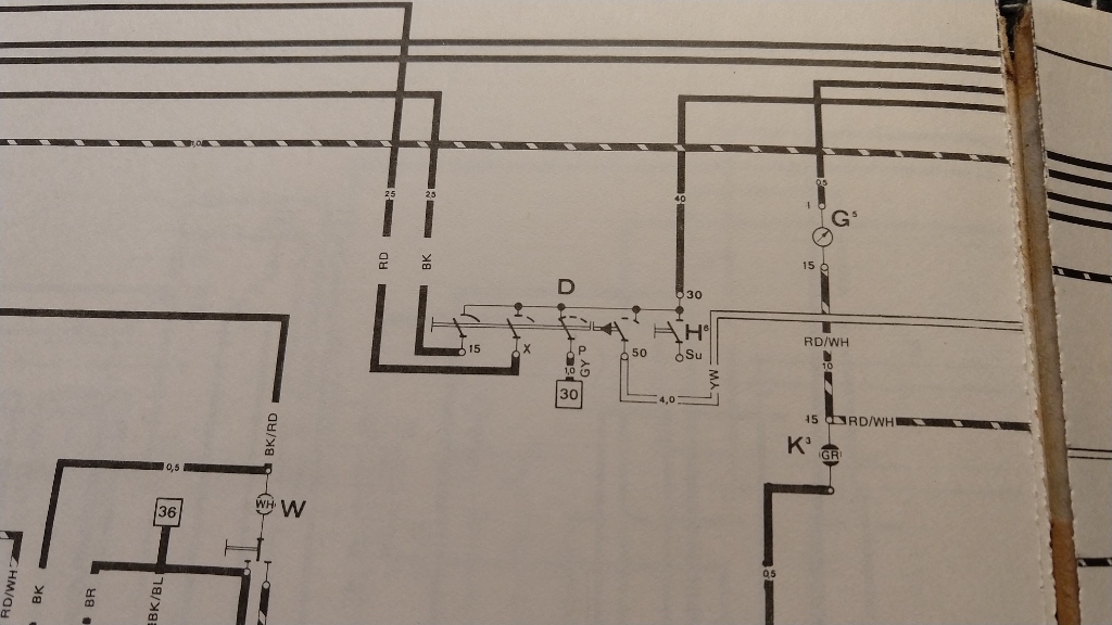

Fuse 8 is powered by pin X on the ignition switch (D). Fuse 9 and relay board/ignition coil are powered by pin 15 on the ignition switch.
Notice pin 50 on the ignition switch which goes to the starter.
Therefore the starter, ignition coil (fuse 9), and fuse 8 are all controlled separately by the ignition switch.
Pin P (going to electrical column 30) on the ignition switch powers the Euro function for the turnsignals when the vehicle is off.
The issue is still pointing at the ignition switch. The only test left is to find the wires coming from ignition switch in the steering column and find and measure the voltage on the wire from pin 15 to isolate the ignition switch.
