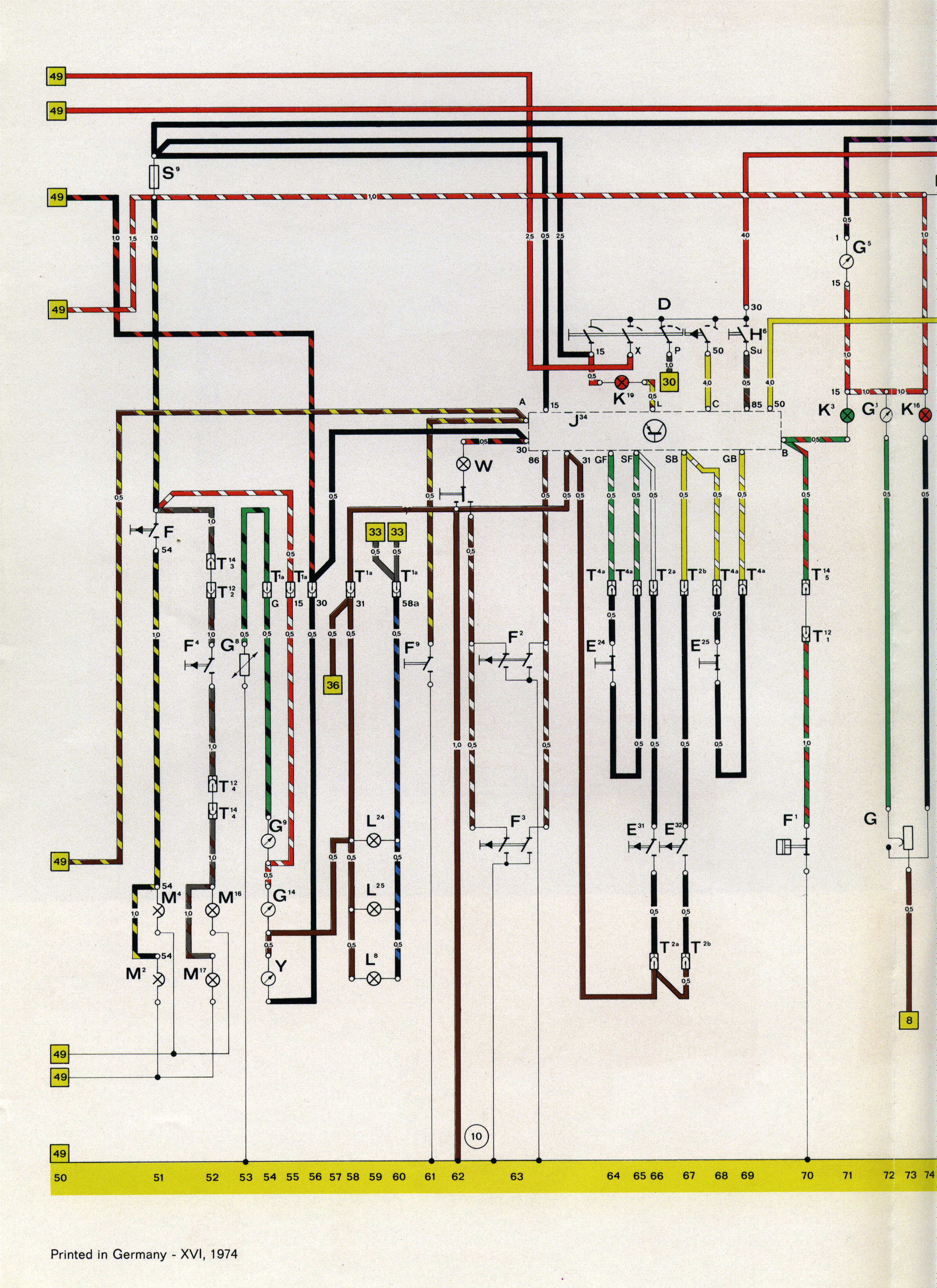

Issue: There's no power going to the coil/fuel pump when I turn the key. (you can skip the history and jump down to the ALL CAPS and (IMG:style_emoticons/default/popcorn[1].gif) to see more about the issue)

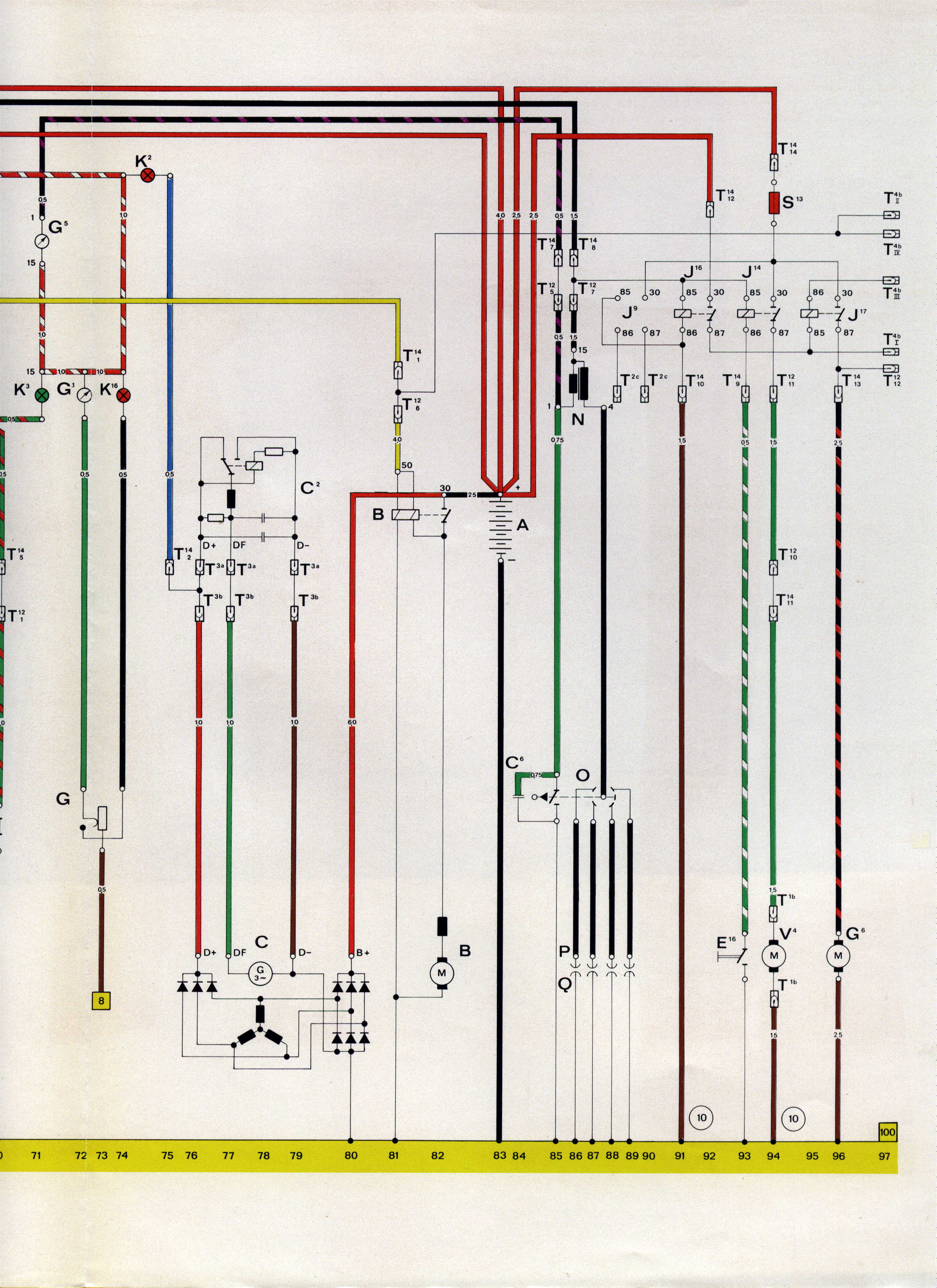

(IMG:style_emoticons/default/popcorn[1].gif) ISSUE: WHEN WE TURN THE KEY, THERE'S NO POWER TO THE COIL OR FUEL PUMP.
Since we replaced the fuel injection with carburetors, we no longer have the ECU in the car. (in fact, I no longer have the ECU or any of the fuel injection parts anymore, they are long gone at my other friends garage) Not sure if that was a mistake, I thought I didn't need it anymore since the FI was gone.
My VW friend is not familiar enough with 914 electrical to find the issue. Could I have a bad relay? I see that there is a port for the white wires from the ECU to connect to the relay panel. Is there a part I need there in place of the ECU wiring? Is this a common issue with a carb replacement? Other electrical things work, (headlights, and whatnot) and if I continue to turn the key, the starter starts to crank, but no power to the coil/fuel pump.

Spoke   There is no power on either side of fuse #9 under...   Dec 14 2019, 12:58 PM
pastormacman   With the key OFF, there is no power to the fuses f...   Dec 14 2019, 01:35 PM
Spoke   With the key OFF, there is no power to the fuses ...   Dec 14 2019, 06:39 PM
pastormacman   OK, so here's my update for today. I can...   Dec 15 2019, 09:01 PM
Spoke   Those numbers go to somewhere else on the schemati...   Dec 16 2019, 08:43 AM
Spoke   Fuse 8 is powered by pin X on the ignition switch ...   Dec 16 2019, 08:56 AM
pastormacman   Fuse 8 is powered by pin X on the ignition switch...   Dec 16 2019, 06:50 PM
Tom   Pastormacman, It looks like you are using the ...   Dec 16 2019, 10:20 AM
pastormacman   Pastormacman, It looks like you are using the...   Dec 16 2019, 06:07 PM
