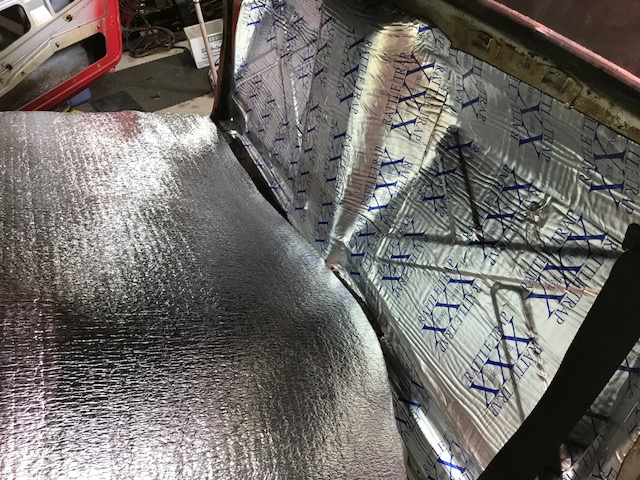

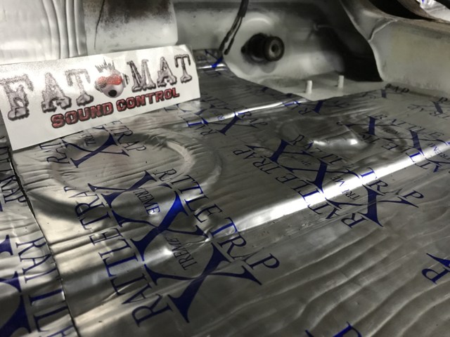

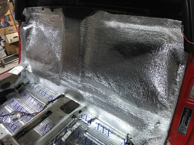

Dr. Phil,
Check out my build link Michigan Build I state all the details, I like both of these materials. I used the EZ-Cool only in the engine bay.

QUOTE(Garland @ Dec 22 2019, 01:44 AM) *
Dr. Phil,
Looks like you are covered! Should be taking out the vibration sound transfer as well as reduced thermal transfer. I wonder what the comparison of dB at compatible speed and rpm would be for your before and after - with/without?
