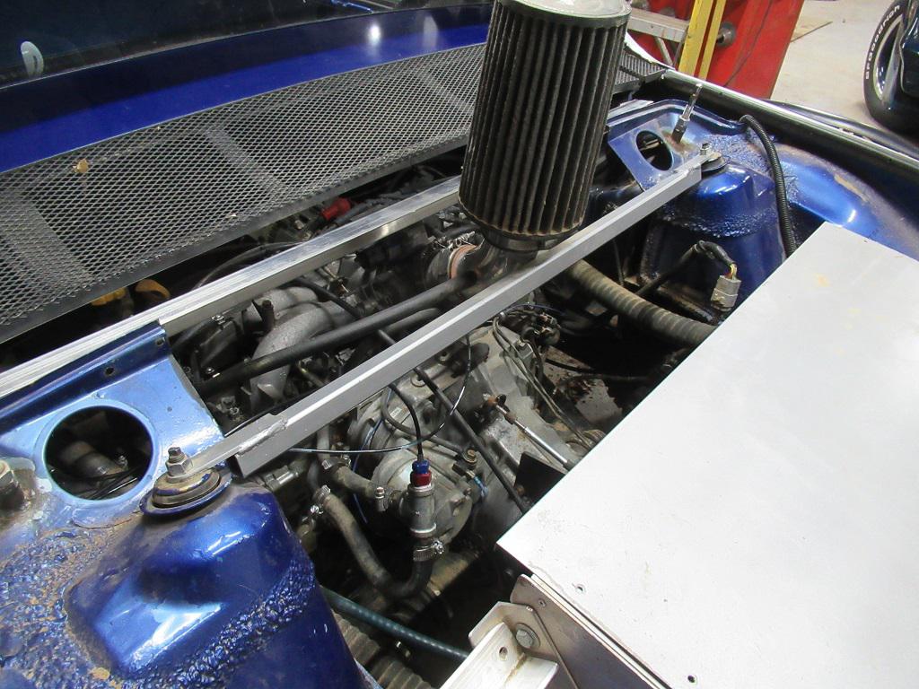

Sort of a shame that such awesome fabrication skills have been put to such an evil use. (IMG:style_emoticons/default/sad.gif) I may have to take a bit of that previous fabriction comment back. Note to Goober: Adding a brace betwen the top of the small diameter shock rods that are already isolated in rubber really isn't much of a structural reinforcement. And to top that off, it will cause your damper rods to flex and then side load the damper seals leading to quick failure. (IMG:style_emoticons/default/headbang.gif) Suspsect it really doesn't matter to this guy. The Home Depot T pipe fitting is another nice touch. ![]() It really hurts to see these cars come to this end when there are literally millions of Civics, CRX's, Miata's and other potential donors for this sort of project. Oh well, another hacked up 914 on it's last life before ending up in the bone yard. (IMG:style_emoticons/default/sad.gif) Only serves to make the rest of the healthy 914 population more rare & valuable with each one that meets it's untimely demise at the hands of folks like this. (IMG:style_emoticons/default/sheeplove.gif) |
