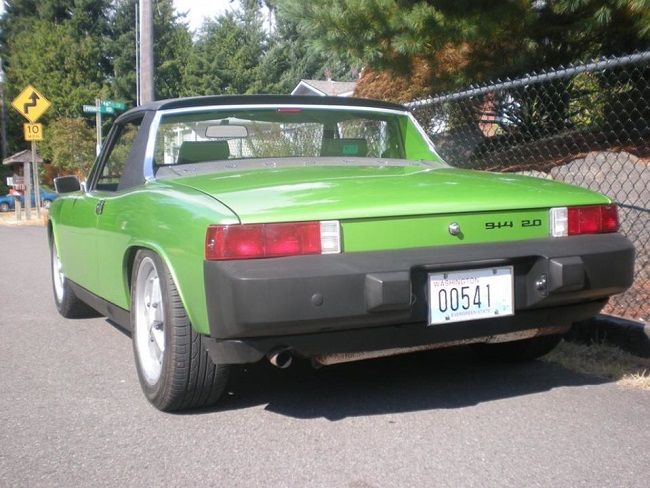

I built these 7.5 x 16s from 16x6s added 1.5 to the backside,, 205/55 tires.. needed about 1/2 to 5/8 thick spacer, cant rember...All stock..
