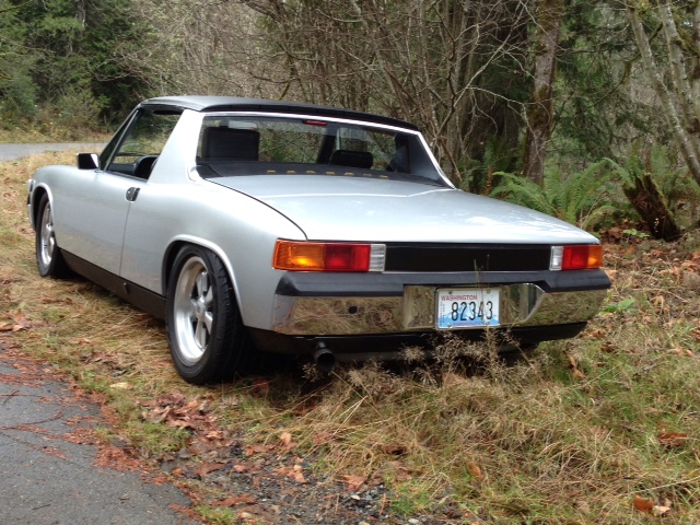

Have Fuchs 6s and 7s with 205/60/15s and had to roll the lips and pull both rear fenders. Was getting paint burn on one side side and rubbing on the other so they both needed to be done. Now all is good but they clear by about a pinky width.
