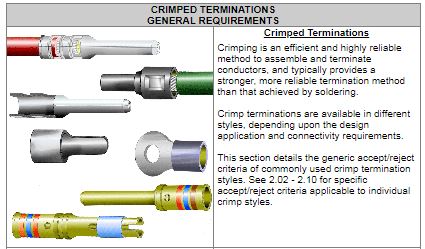

. The tools and the techniqes are far more complicated than the tools required for crimping. It takes training and lots of practice to get soldering right. I say that as USAF trained electronics technician. Nicked wiring from improper stripping, seen it. Overheated wires that melt and degrade the wire insulation, seen it. Underheated wires with a blob of solder just basically sticking two wires together in a high resistance joint, seen it. Improperly designed stress relief that is bent too tightly, and creates intermittent connections as wires vibrate, seen it. Too much solder flux and not cleaned leading to corrosion later on, seen it. Not enough flux, seen it. The list of potential soldering flaws goes on and on.
But let's at least be factual about this. A proper crimp is superior and this isn't just my personal opinion or a desire to disagree with you personally or any of the other posters in favor of soldering. The fact that crimping is superior is based on unimaginable test hours conducted by NASA, automotive OEM's, and the global aviation industry on vibration tables and wiring harness test rigs that most readers of this forum have never seen. It is not just a personal opinion or old wives tale.
"Crimping is an efficient and highly reliable method to assemble and terminate conductors, and typically provides a stronger, more reliable termination method than that achieved by soldering." Excerpted from NASA document.
https://workmanship.nasa.gov/lib/insp/2%20b...s/frameset.html
See section 2.01 for source of the quote and the graphic.
