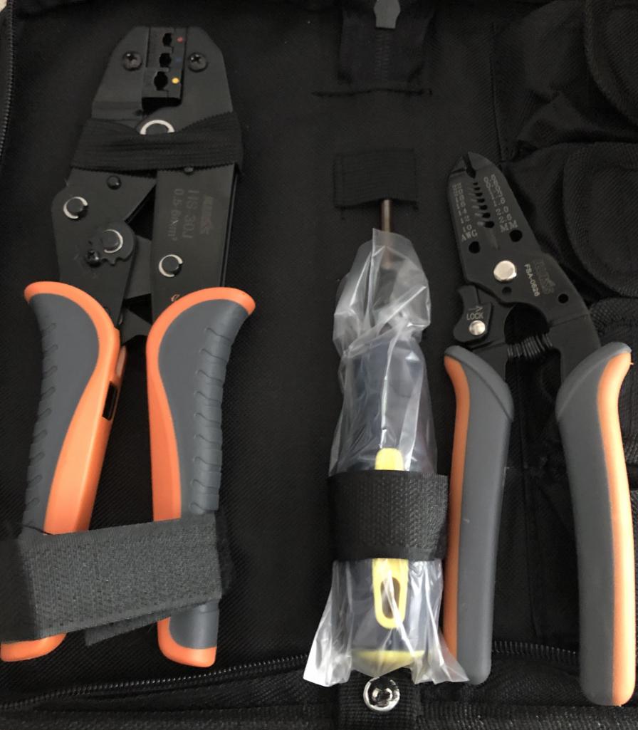

Yeee haaa.
HOLY COW these are nice to use. Thanks for the encouragement gentlemen.

QUOTE(Tdskip @ Jan 9 2020, 12:32 PM) *
Yep, once you go to ratcheting crimpers with the appropriate dies you never go back. And your die set continuously increases in size. (IMG:style_emoticons/default/laugh.gif)
Even a budget-friendly model like you have is worlds above the ubiquitous cheap pliers-type crimper.
If you want to really have fun start pinning connectors with machined pins/sockets (see Deutsch DT or HDP20 series for relatively budget friendly stuff) with a HDT-48-00 crimper or similar with turret and depth stops. (IMG:style_emoticons/default/drooley.gif)
