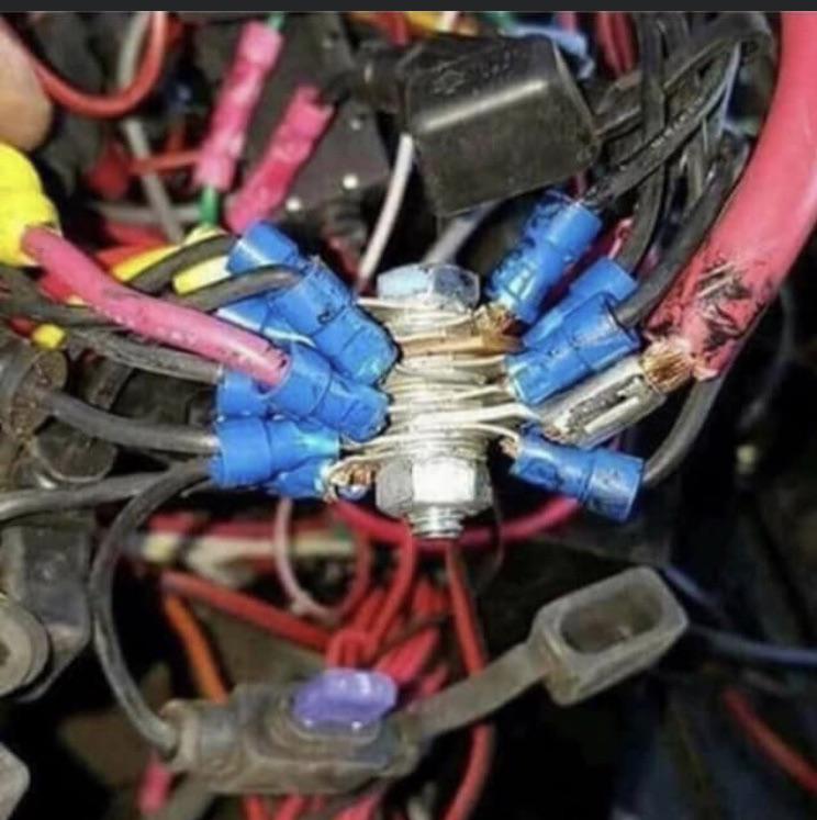

Larmo63   Hold my beer.........   Jan 9 2020, 09:01 PM
ClayPerrine   Hold my beer......... http://www.914world.com/bb...   Jan 10 2020, 08:50 AM
Tdskip   [quote name='Larmo63' post='2776095' date='Jan 9 ...   Jan 10 2020, 09:20 AM
gereed75   Don’t start with the substandard examples - I ju...   Jan 10 2020, 08:02 AM
