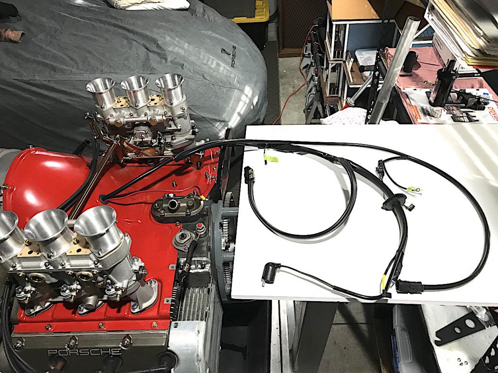

Professional.....Perry Kiehl. Engine harness is a thing of beauty.Attached Image
