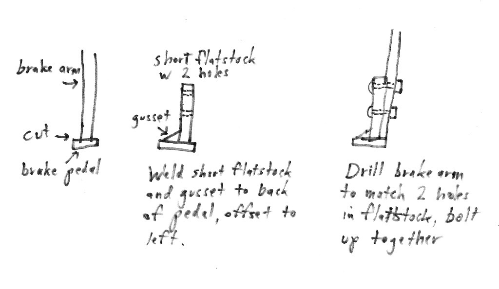

I have the morph footwell 8" sub enclosure, it does fit the area OK, but you can't install it without cutting up my close to perfect OE carpet. Then you have to protect the woofer with something, the PO had an AL footboard with big ass spacers, you have to be a munchkin because it takes up so much legroom. It came out of the wife's 914, it's likely going back because her carpets are crap, but I'll figure out a better guard for the speaker.
I reason I don't care for the console is because anything but slippers I catch my right foot between the console and brake pedal. I think I'll DYI a console/box but space the speaker hole a bit more rearwards then the one in Mark's above pic. That way I hope I can clearance the right foot area a bit better.

"reason I don't care for the console is because anything but slippers I catch my right foot between the console and brake pedal."
Hey Mark, I have size 13 shoes and I too would drag my brake pedal with my right foot. I finally hacksawed the brake pedal off right at the end of the arm, (did it in the car without removing pedal box). Then I welded a short piece of steel 1/4 inch flat stock with 2 predrilled holes to the back of the pedal, offset to the right side of the pedal, as you look at it from the front. Then I welded a small steel gusset between the extension arm and the pedal to add support from pedal pressure being now on one side on the extension arm. Finally I drilled 2 matching holes in the brake pedal arm aligned with the extension holes and bolted it all together on the left side of the brake arm. I have a included a crude diagram below to show the simplicity of the process. It took me about 30 minutes to do, all "in car", and was not as hard as I made it sound. Now my brake pedal has about a half inch clear on the side of my big shoes, and makes a real pleasurable difference driving the car.
