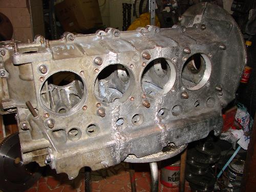

Here you go (IMG:style_emoticons/default/biggrin.gif)
https://www.thesamba.com/vw/forum/viewtopic.php?p=4389012
(IMG:http://www.914world.com/bbs2/uploads_offsite/www.thesamba.com-26-1579195247.1.jpg)

Mark Henry   No, but it has been done with VW engines. In fact ...   Jan 16 2020, 11:01 AM

Mark Henry   Here you go :D https://www.thesamba.com/vw/foru...   Jan 16 2020, 11:20 AM

Mark Henry   The cheapest way to do this would be to use a Tatr...   Jan 16 2020, 11:32 AM
