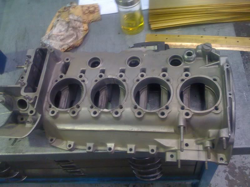

my new favorite pic.... porsche 8cyl
911 based
