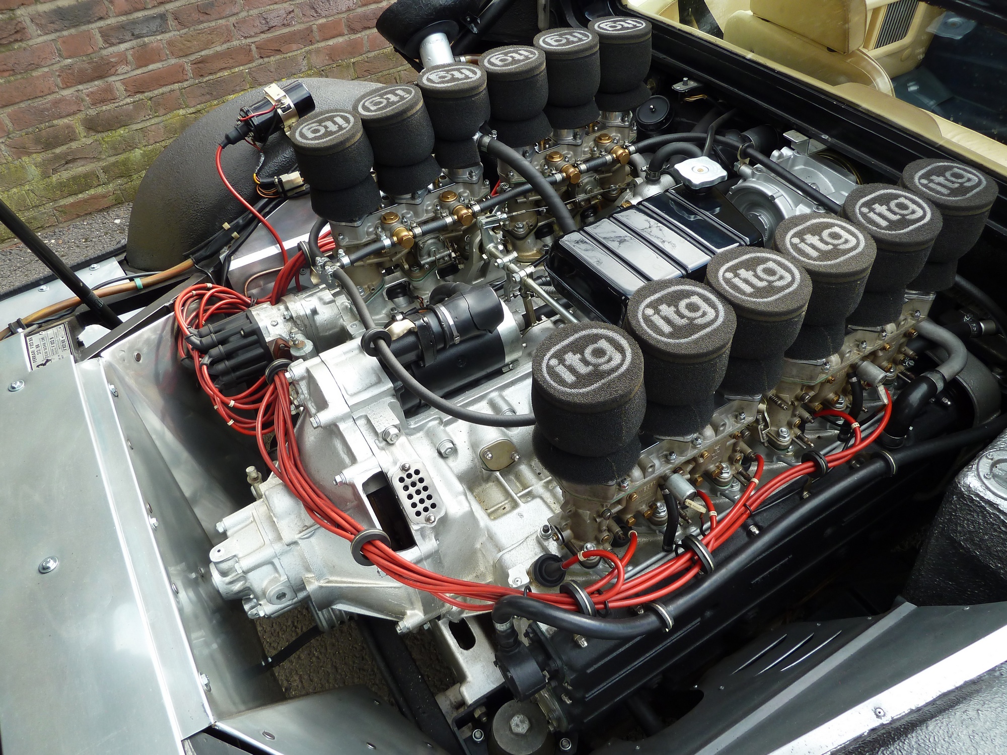

Rav914   How about a motor from the Ferrari 512BB? It...   Jan 16 2020, 01:16 PM
SirAndy   How about a motor from the Ferrari 512BB? It...   Jan 16 2020, 01:27 PM
