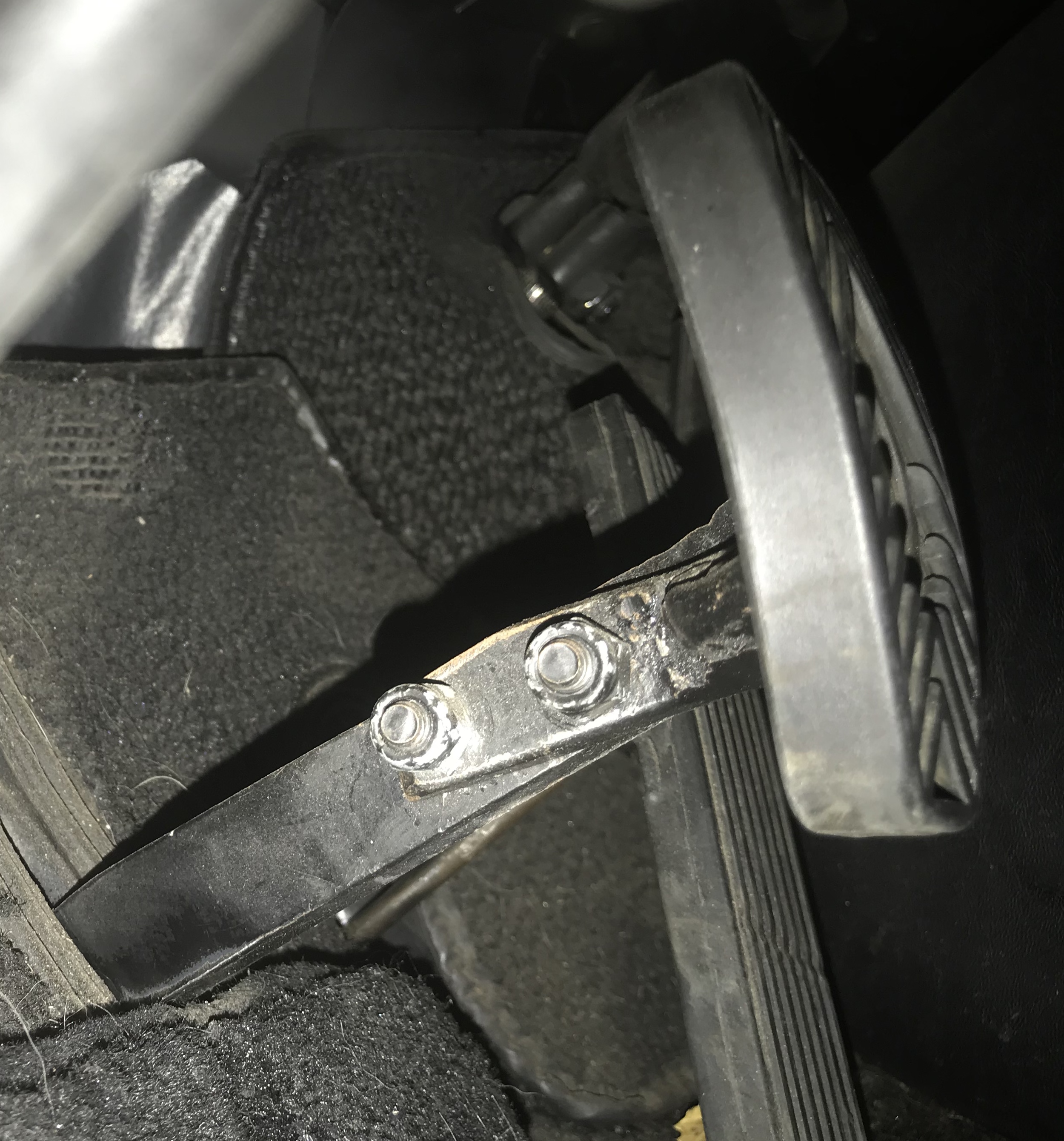

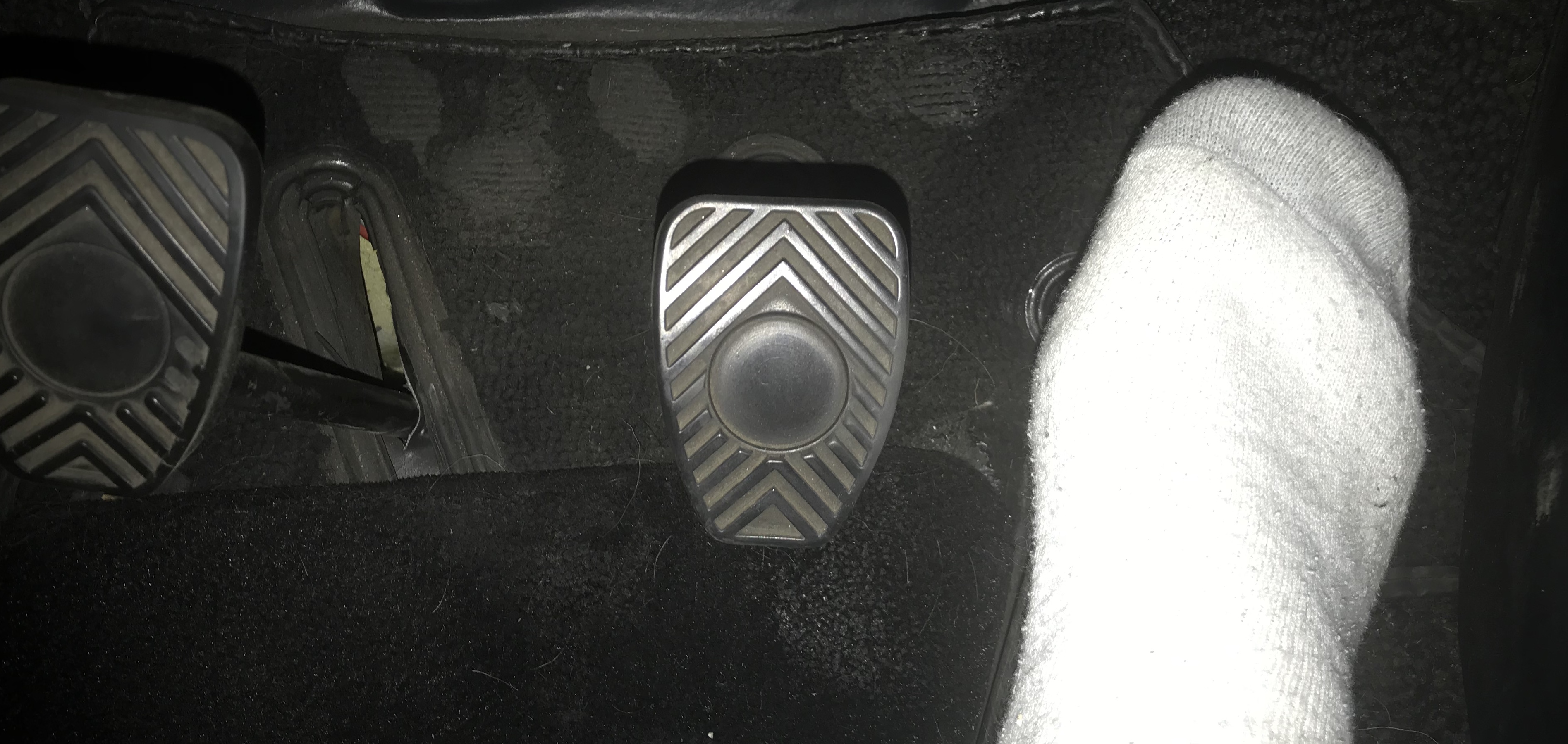

I posted this reply in another thread about speakers, so I thought I might offer this fix in it's own thread. Mark commented: "(the) reason I don't care for the console is because anything but slippers I catch my right foot between the console and brake pedal."
I hear this from a lot of 914 owners if they have big feet. Here's a relatively easy fix, and really improves the problem.
Hey Mark, I have size 13 shoes and I too would drag my brake pedal with my right foot. I finally hacksawed the brake pedal off right at the end of the arm, (did it in the car without removing pedal box). Then I welded a short piece of steel 1/4 inch flat stock with 2 predrilled holes to the back of the pedal, offset to the right side of the pedal, as you look at it from the front. Then I welded a small steel gusset between the extension arm and the pedal to add support from pedal pressure being now on one side on the extension arm. Finally I drilled 2 matching holes in the brake pedal arm aligned with the extension holes and bolted it all together on the left side of the brake arm. I have a included a crude diagram below to show the simplicity of the process. It took me about 30 minutes to do, all "in car", and was not as hard as I made it sound. Now my brake pedal has about a half inch clear on the side of my big shoes, and makes a real pleasurable difference driving the car.

The idea makes sense but the diagram is drawn as if the pedals pivot above the driver's feet.
Does this interfere at all with the spacing to your clutch pedal/clutch foot?

QUOTE(TargaToy @ Jan 16 2020, 10:51 AM) *
Sorry for the crude drawings. Here’s a couple of pictures that should address your questions...
