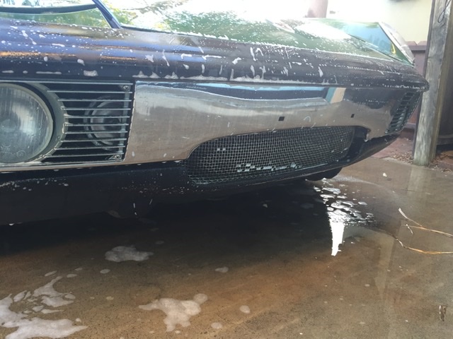

QUOTE(mepstein @ Jan 16 2020, 08:45 AM) *
It was the 908 race engine and 908 trans. Since the 908 was already mid engined, it fit really well - once Porsche moved the trunk firewall. Using an aircraft engine will be more work than Porsche had to do since you have to fit everything around the engine, adapt a trans, clutch, headers, etc. and then you don’t really see anything in a 914 engine bay.
I do want to do a silver 914-8 tribute but just exterior and interior. I’ll be happy with a six in the engine bay.
About 19 years ago I replicated the 914-8 Oil cooler opening when I shoehorned a 3.2 L Motronic motor into my car at home in my garage. As I cut the opening for the oil cooler on the factory sheet metal I was able to break bend a flap of metal backwards to add rigidity and I also was able to retain the factory tow hook underneath the trunk by adding vertical support ribs back onto the bottom of the trunk.
