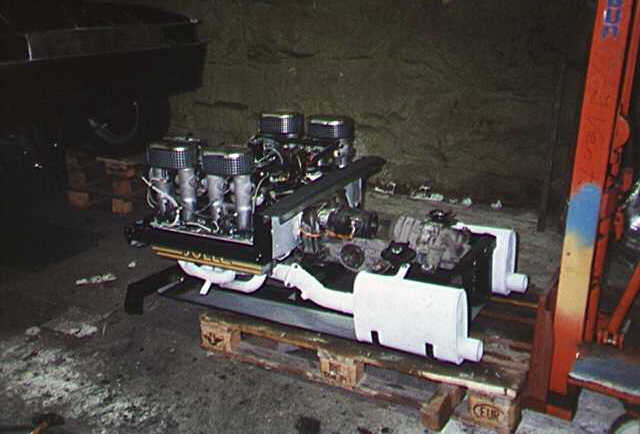

Mark Henry   Emerson Fittipaldi, flat 8 VW engine. https://jal...   Jan 16 2020, 11:13 AM
ClayPerrine   Emerson Fittipaldi, flat 8 VW engine. https://ja...   Jan 16 2020, 11:36 AM
GregAmy   Emerson Fittipaldi, flat 8 VW engine. Holy cow.....   Jan 16 2020, 11:49 AM
rgalla9146   Emerson Fittipaldi, flat 8 VW engine. https://ja...   Jan 16 2020, 03:57 PM
Mark Henry   [quote name='Mark Henry' post='2778003' date='Jan...   Jan 16 2020, 04:24 PM

sixnotfour   my new favorite pic.... porsche 8cyl 911 based   Jan 16 2020, 11:21 AM

porschetub   Didn't someone in Europe do an 8cyl T4 many ye...   Jan 16 2020, 02:17 PM
Mark Henry   Didn't someone in Europe do an 8cyl T4 many y...   Jan 16 2020, 03:49 PM
sixnotfour   [quote name='porschetub' post='2778070' date='Jan...   Jan 16 2020, 04:22 PM
