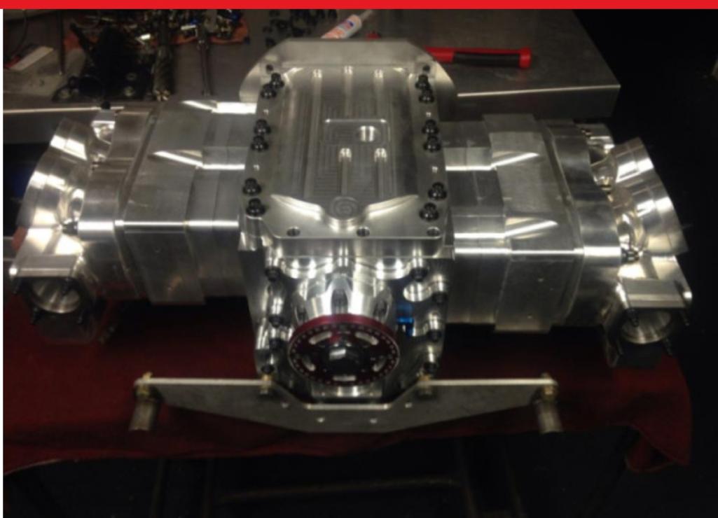

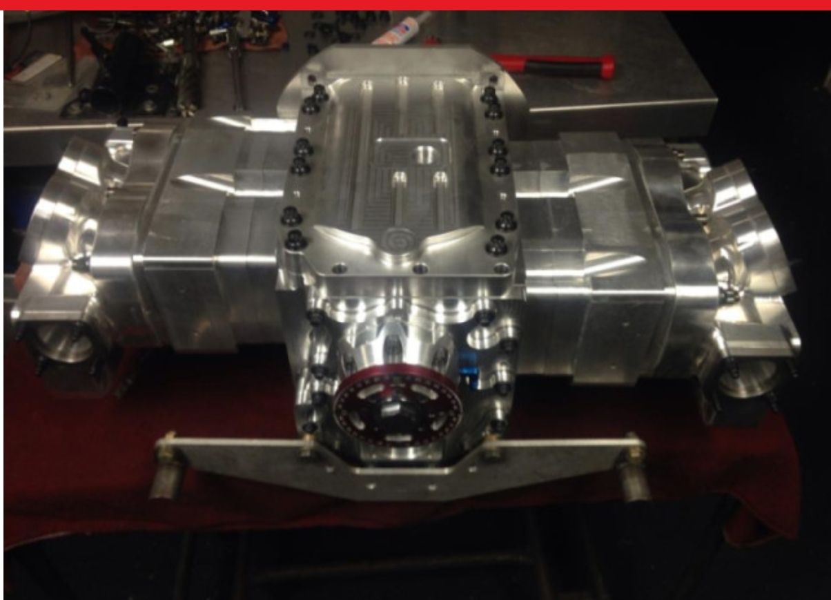

sixnotfour   100% Billet 12,500 Noonan https://noonanrace.com/...   Jan 17 2020, 07:40 AM

sixnotfour   NOONAN does billet cases.......no casting...   Jan 19 2020, 09:30 PM
Mikey914   NOONAN does billet cases.......no casting... I h...   Jan 20 2020, 11:40 AM
