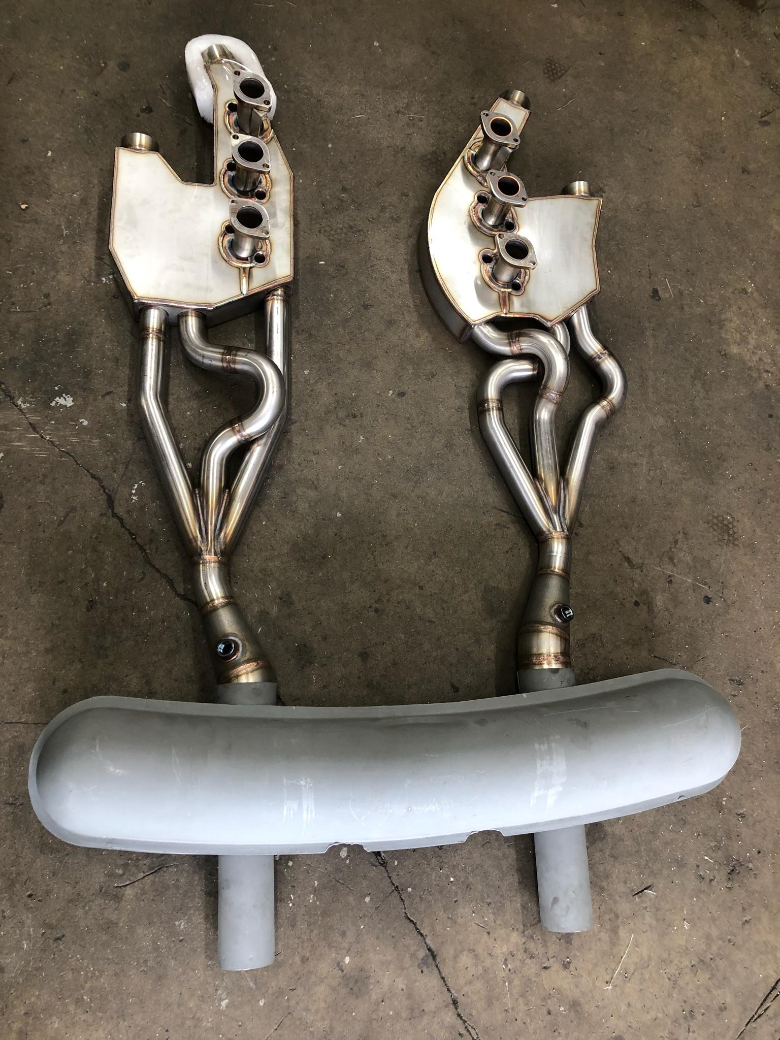

I would love to do a setup for the 8.. Attached Image Attached Image
