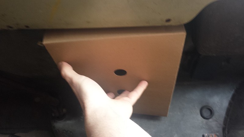

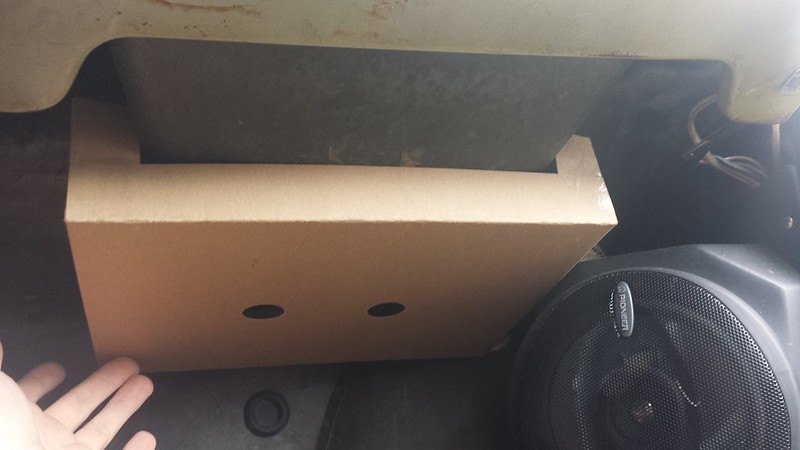

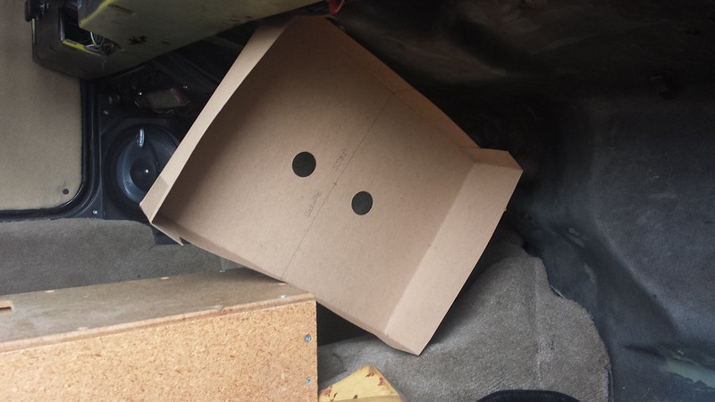

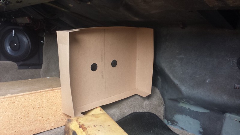

QUOTE(FlacaProductions @ Jan 19 2020, 02:15 PM) *
Dang- that's what I thought
Peaked my interest enough to get crafty. The Rockwell ss8p is a better fit.
Between the seat rail.
Custom center console.
Under the dash with and without the glove box.
