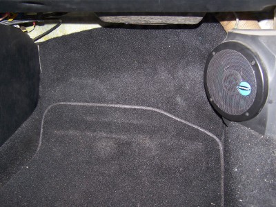

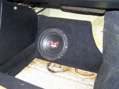

the best place is to put a sub woofer is where the foam floor board block exists on the passenger side. Totally hidden, takes up no space, sounds GREAT and does not chop up the car. Here is a picture if anyone wants to make one: http://www.autoatlanta.com/Porsche-914-Spe...N-BAA31934.html
It is very easy to make, basically the pattern of the block with a leg to support it. We have made hundreds over the years and the sound is great, and TOTALLY hidden

This isn't an ideal solution. A subwoofer will perform far better in a sealed and ported enclosure. But it might be better than nothing.…
