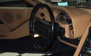

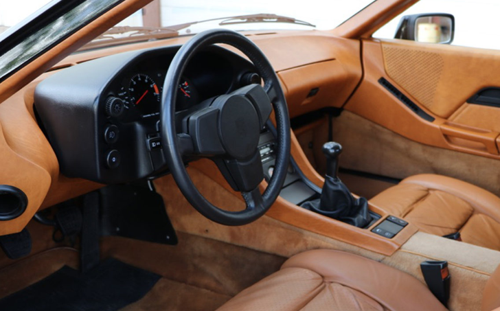

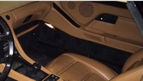

Sounds like a slick setup. I am planning to use a JL 5-channel amp to power a JL 3-speaker component system for the stock speaker pods and doors, with the possibility of rear "fill" tweeters in the targa bar and the fifth channel for a sub. Was "arming" my old Pioneer amp via a factory 914 defroster switch on the dash (found an old one at EASY), which lit up when you pulled it out to tell you the audio system was on, and then using AUX in to plumb by iPhone in with RCA cables. Worked really nicely, but may go to Bluetooth for the next iteration of this setup. Just need a place to put that sub. Have looked at some of the slim-line subs out there, but so many of them are powered. Would love to see what you come up with.
And good point on the port tube. I may reference the size of the port tube in an old JBL bass tube I think I still have, and just go with that. Any bass setup is gonna improve on no bass setup, and I suspect JBL did some homework on the size of that tube vs the 8-inch subwoofer.
My goal is to have "invisible" audio that actually sounds good, with the only clue that there's a system being 6.5s as the front of the doors. With 914Rubber's ABS plastic door card blanks, I've started to wonder if the 6.5s could be mounted behind the door cards with "perforated" basketweave vinyl over them...much like the early 928 speakers (see below). On black, you might not even notice the holes in the basketweave. Thoughts? Good idea? Terrible idea? (IMG:style_emoticons/default/unsure.gif)
